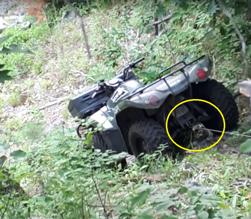

I made my own "****** block": its just a steel u-bolt attached to the hitch that I ran the winch cable through.

👍 great

make sure to watch your fairleed especially if its a roller. They were never designed to take the load that way it will bend, or break the bearings or bushings. I found out the hard way a few times..
