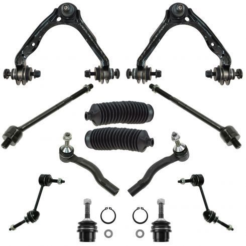

Found a fairly comprehensive front end kit for a great deal...like $137 for all of this...
2006-11 Ford Lincoln Mercury Steering & Suspension Kit 12 Piece Set - 1ASFK05040
https://www.1aauto.com/2006-11-ford-...t/i/1asfk05040
I'd rather go with something more dependable like Moog at least on the lower ball joints.
What do you think? Should I go with this kit and save? She's got 320k on her now.

Personally i would go with the OEM from rock auto or a good name brand... You get what yu pay for
