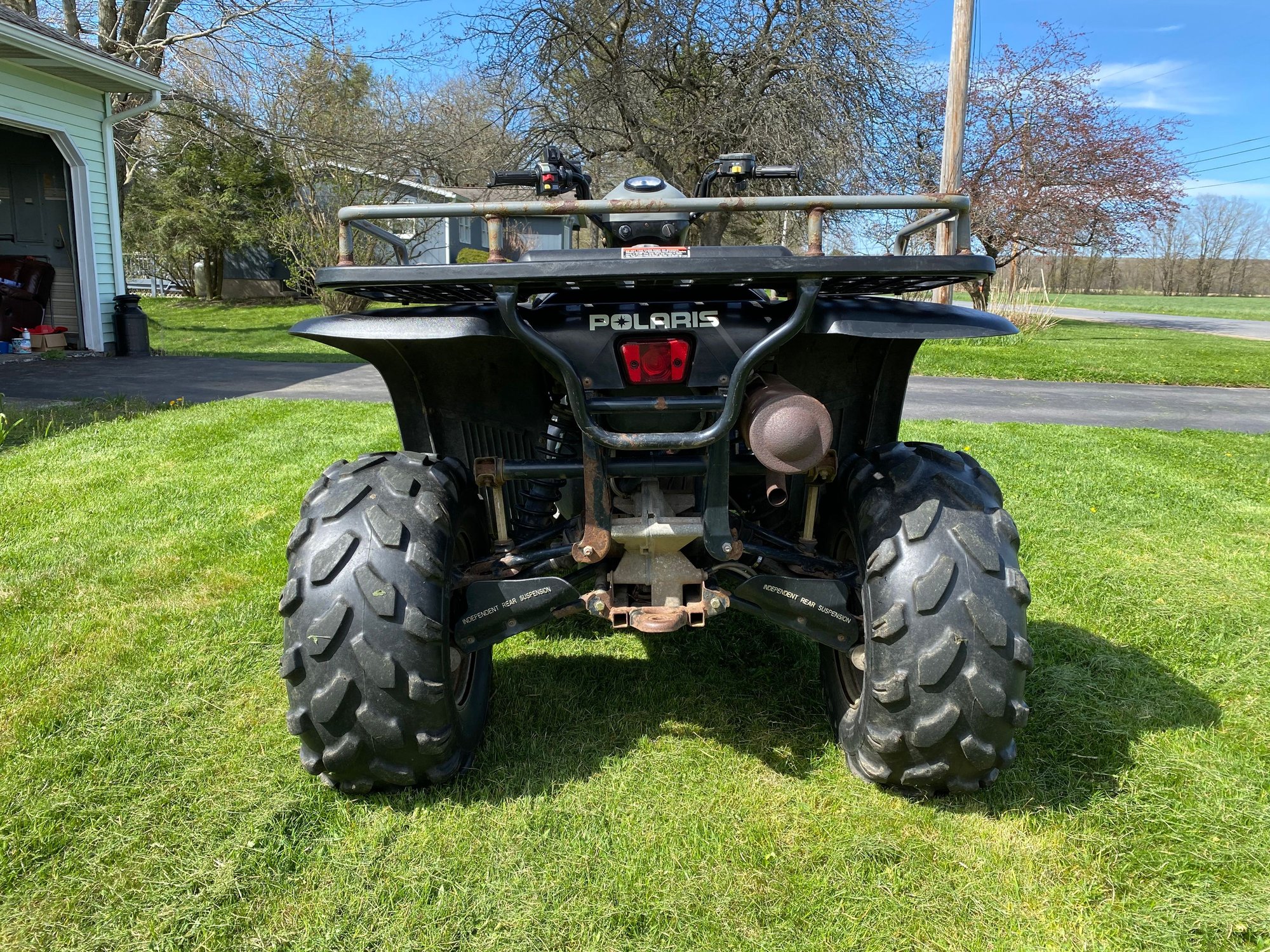

Hey guys, I have a 2002 Sportsman 700 that I got for free a couple years ago but had to rebuild the whole engine on. I should have tried to deal with the frame when i had everything off of it, but you know how it goes sometimes.
Anyhow, the whole quad, even before I got it, looks like its been sitting outside for last 10 years. The frame is pretty rusty up in the back, a lot of the paint is flaking off with rust underneath. I'm not looking to put a ton of time or money into stripping everything and repainting the whole frame, so I'm wondering if anyone knows of any good paints for for cleaning up the rusty areas and repainting them.
I'm not super invested in the ATV and it doesn't need to look perfect, I just don't want to see so much rust when i look at it. Any and all recommendations would be greatly appreciated! Thanks

Its just surface rust, the underside of the frame looks pretty good actually for being 18 years old. This is the rear
I’m just wondering what the best paint to slap on it so it doesn’t look as rusty
