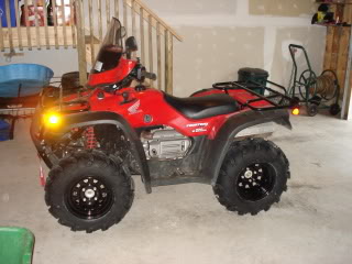

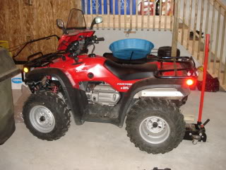

So I went with 25x8x12 in the front, and 25x10x12 in the back Mudlite XL on ITP Delta's (I cheeped out on the alloys... and got a Warn RT25 )
They work great, and the bike is still narrow enough to ride out of the huge ruts on the trails. I have got into some deep slop, and I think 26's would have been to much to spin fast. Thanks for the advice!
Before
After
Chad
