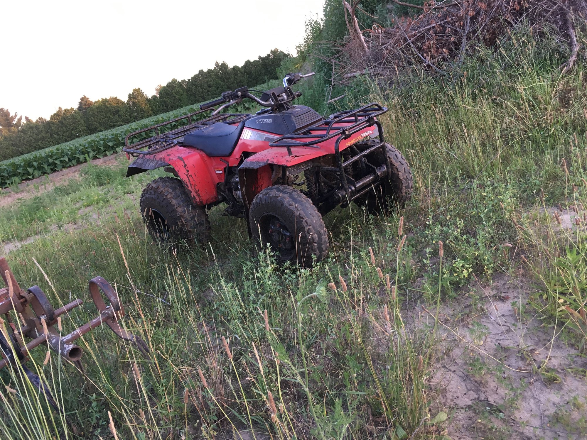

I've recently acquired a 1985 Trx250 Fourtrax (utility quad). This ATV's been sitting for about 10 years and I recently bet my grandpa that if I could get it running, it was mine. Guess who won! It's been about 6 months since then. I have noticed if the petcock isn't shut off the gas leaks into the crankcase, I'm not the only one who rides the machine which is why it makes this such a big problem. My elders have told me that the float is probably being kept open by something, most likely something from the rusty gas tank. Would a carb kit stop this?
Here's a photo of the quad. When I received it, my grandpa told me he put an old tractor muffler on it. I have recently put a light on it and changed the oil multiple times due to the issue I mentioned earlier. I've also painted the wheels black and the lug nuts red. It's getting to be a pretty old quad but it beat my buddies 2001 trx350 and my cousins 1989 (I think) trx 300. I'm also sure this number is a little off but my buddy drove beside me on his 2017 Renegade 570 and clocked me at about 87kph, I live in Ontario.
