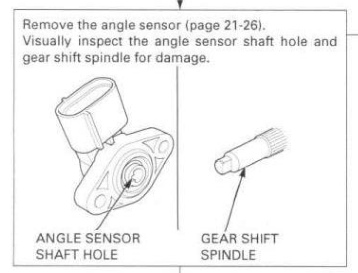

When shifting gears - either manually or with the pushbuttons, does the gearshift spindle (see attachments), rotate incrementally each time you change gears or does it just pulse and remain in the same position? The end of the spindle is like a half-round and the angle sensor fits over the shaft end so that when you shift, the spindle rotates and the angle sensor senses the position and translates the information into a gear position which then shows up on the combination meter.
In my case, the spindle just pulses or jumps and remains basically in the same position - ie, the half-round end does not rotate incrementally to five different positions.

The gearshift spindle returns to the same position after each shift.
Are you able to shift at least once when you first turn it on?
Do you have to use a lot of pressure to manually shift, or is it fairly easy?

I assume you know the resistance varies from about 1000 to 5000 ohm.
The angle sensor is usually not the problem.
I also assume you know the picture above is missing a gear.

I'm going strictly from the manual for the resistant readings -- I'm not that smart.
The gear that's missing is on the motor side.
