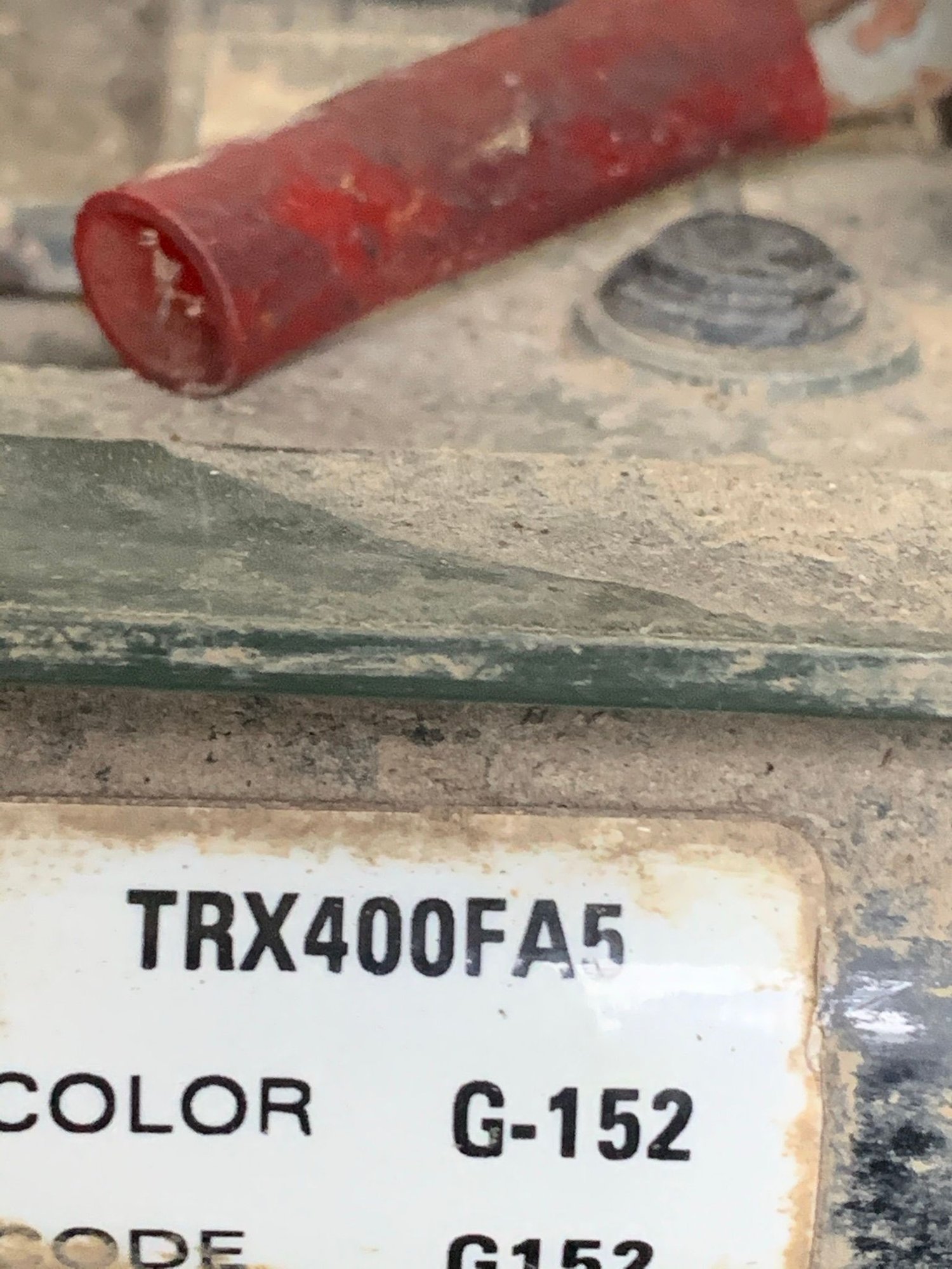

Got this from my cousin it has been sitting in a garage for about three years he never ran it anymore changed oil new battery went ahead replaced the carb with new one. It starts and idles and runs but white smoke coming out bad tried some of this stuff put in oil help with rings and smoking still smoking. Any idea what should be my next step. Was cheaper owning a boat I think 😂
