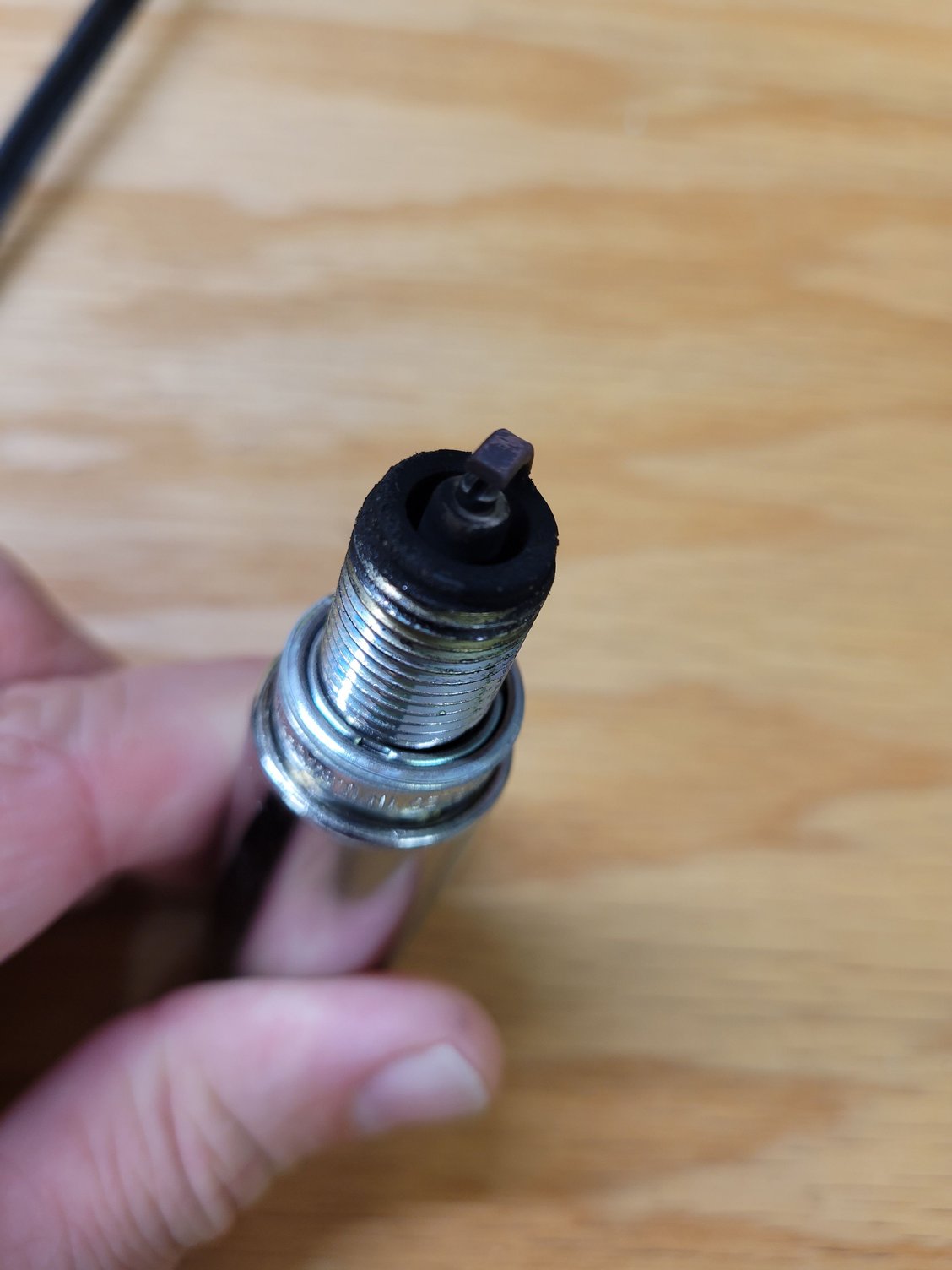

Is the spark plug black and sooty when the fault is on? The EFI system relies on the sensors to tell it how much fuel to inject. Just possible that the engine temp sensor is telling it that it is at -20 degrees all the time, so on full choke. This wouldn't throw a fault code. Other possibilities are conventional ignition problems, faulty plug, or coil, or pickup coil on flywheel, but I know Suzuki EFIs fault code if the spark is lost, so expect Hondas would do too. I assume you changed the injector along with the throttle body?
Honestly, I haven't pulled the plug yet ... it was new when I did the top-end rebuild & it never really crossed my mind to give it a look-see. I'll pull it for inspection.

As you haven't changed the plug, the first thing is to do so. A new plug doesn't always equal a good one. Another thing I forgot to mention is the voltage at the battery with engine running. A faulty voltage regulator can throw weird faults on the EFI system, though as over, and under, voltage readings on some sensors is detected by the ECU, and this throws a fault code, I would have expected a code to pop up.

Spark plug tells me what I was smelling ... engine is running rich "for some reason".

Well, I replaced the following components:
- Spark Plug (NGK BKR5E-11)
- Ignition Coil (30510-HP5-601)
- Spark Plug Boot (30700-MBN-671)
- Engine Coolant Temp (ECT) Sensor (37870-HN8-A61)
- Intake Air Temperature (IAT) Sensor (37880-MCA-003)
I also did the TP Sensor Reset Procedure that I should've did when I replaced the throttle body assembly.
So far, so good ... exhaust didn't seem to smell as rich as it did before too. Maybe I sorted it?
