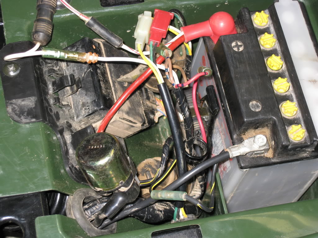

hey hay ok well i charged my batt. because i thought maybe thats why it wasnt starting aftr the charge the oil light and netural light come on now but seems as if they are flickering and take a sec t get to full brightness i guess you would say and when i het the start button i hear a little POP but no turn over
the little gold cylinder part is what is making the POP sound and if i hold the start button it almost sounds like current going through but thats it any ideas

The cylinder looking thing that makes popping noise is the STARTER RELAY. The popping noise is the internal swtich of the STARTER RELAY that is trying to make a contact so that the current can flow from the battery to the starter. It's trying to do its job. What is the voltage of your battery? Looking at the photo of the battery's (-) terminal, it doesn't look too healthy. I see some white dried up sulfuric acid residue. See if you can start the engine by using the boost charger if your battery charger has that function, or jump start from your car to start the engine. If engine starts that way, you need a new battery.

funny as it seems the pic doesnt give the battery justice i did buy a new batt but was chargin while i took the pic this batter is producing about 12 with no power to it same as the new fully charged one i bought... so is that sound normal to here from the starter relay i took it out and was thinking of getting a new one the guys at my local dealer are kinda ***** and i think i can do most the stuff on my own... if thats normal then ill put it back in and try the new batt.. ill post new pics thanks for all the input it is greatly appreciated

Yep, the 12 v is too low. A heathy battery should have 12.5 V or higher with engine turned off. The popping noise is more prominent and it is "normal" with a weak battery. A good heathy battery would not make that noise. Instead, the engine would start right away. I don't know what kind of new battery you bought but I've experienced better cranking power from MF sealed type battery (usually black casing) than a fill type (usually white casing so fluid level can be checked) as I see on your photo. Another benefit is no water adding is needed so no acid leak in case of overcharging or over filling.
