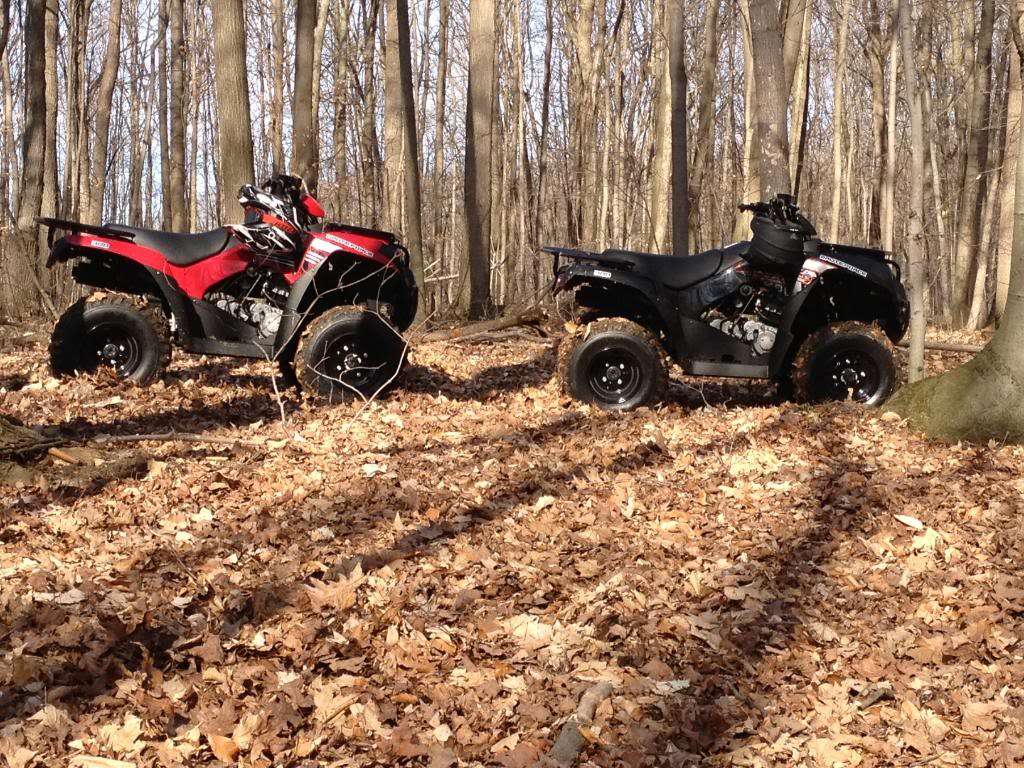

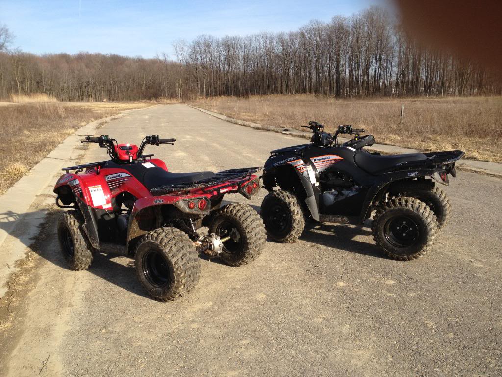

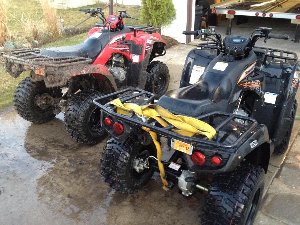

Very impressed with these machines. Went through a spot that I knew was bad and went for it . Little bugger crawled right through it ! We had to make a few passes after that and we loved every min of it .
He's a few pics of us out so far
We hope to make it up north this wknd here in mi to take in some of natures wonders . Around home it's just flatland suburbia
. We still make the best of it and have had some places that made us wonder if we could make it ?Very impressed with these machines. Went through a spot that I knew was bad and went for it . Little bugger crawled right through it ! We had to make a few passes after that and we loved every min of it .
