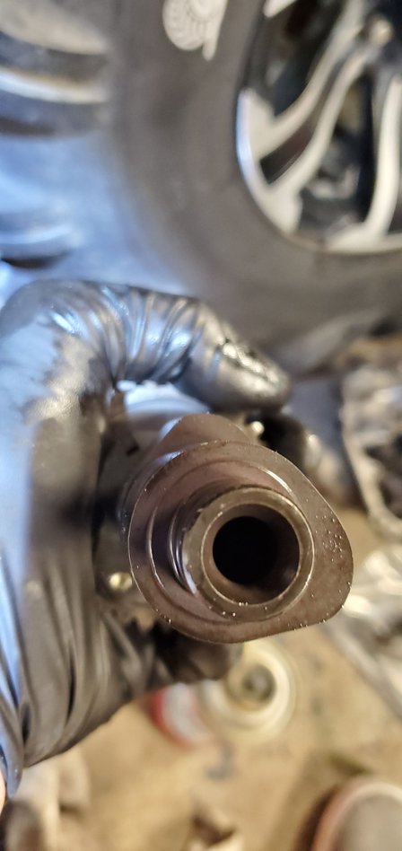

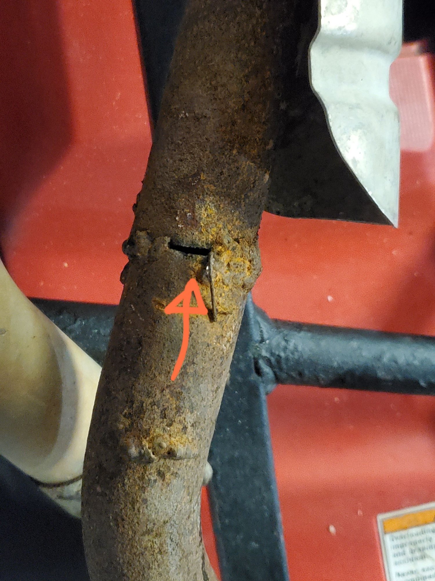

I adjusted the valves to the manual specs. They were all a little tight, but not too far off. The chain tensioners both appeared fine with the tensioners only extended about half way out. The noise is still there. I did find an exhaust leak, see attached picture... this was on the front cylinder pipe and was in a concealed area of the pipe. Any chance this could be causing some of the noise?
Old Dec 17, 2019 | 03:55 AM
Posts: 7,488
Likes: 387
No, I still think cam, followers, or a valve seat loose. You are going to have to take the head(s) off anyway so also check the pistons and bores for wear, piston slap makes a somewhat similar noise, but less sharp and faster, as a rule. Use of a screwdriver/stethoscope may narrow down which head is giving trouble.

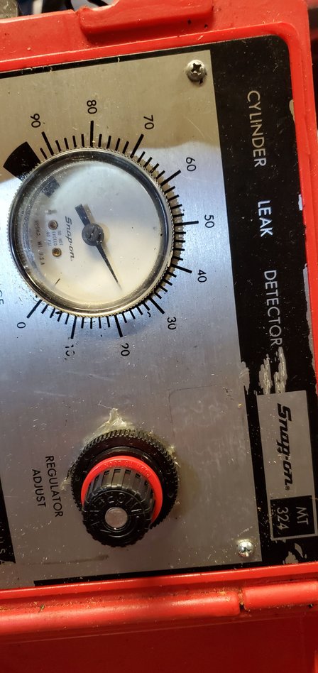

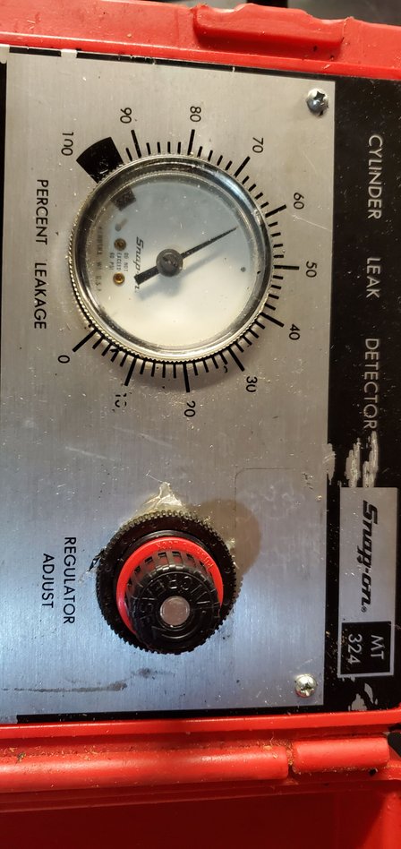

I did a leakdown test on both cylinders. I got approximately 24% leakage on the rear cylinder and 60% leakage on the front cylinder, with much of it feeling like air was coming out of the exhaust and intake on the front cylinder. Should I now concentrate on pulling both heads or just the front? Thanks!

Take a look at the front for the compression issue, but I would check with the stethoscope first, noisy valve gear doesn't always mean low compression, so the noise could be coming from the back cylinder head. I don't have a leak down tester, a compression test tells you if something is wrong, and inspection tells you what, when you take the head and cylinder off.

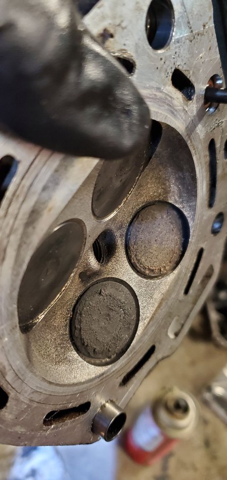

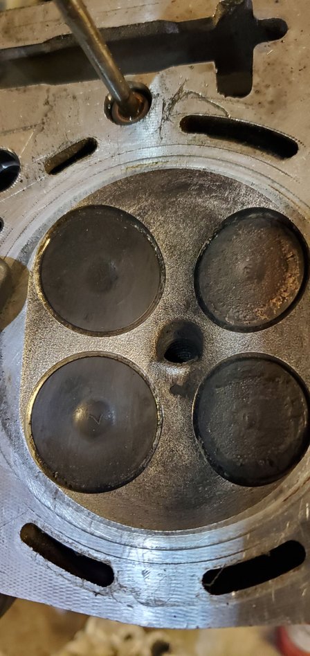

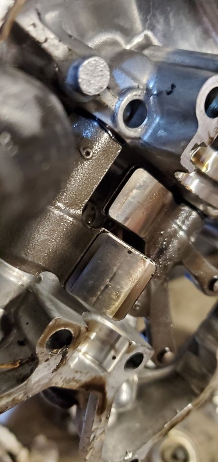

I checked the compression and got 50 on the rear cylinder and 32 on the front cylinder. The manual calls for 36 - 66 psi. I pulled the front cylinder head to take a look.
I am not quite sure where to go from here... Thanks!

Can't tell much from photos. Measure Piston(s), rings and bore(s) for wear. Remove valves and check seats are not loose. One cam follower seems a bit odd, but you can tell better than me. Measure cam lobes for wear, Check rocker shafts for wear. Something is worn somewhere to make that much noise, you just have to check everything to find what.
