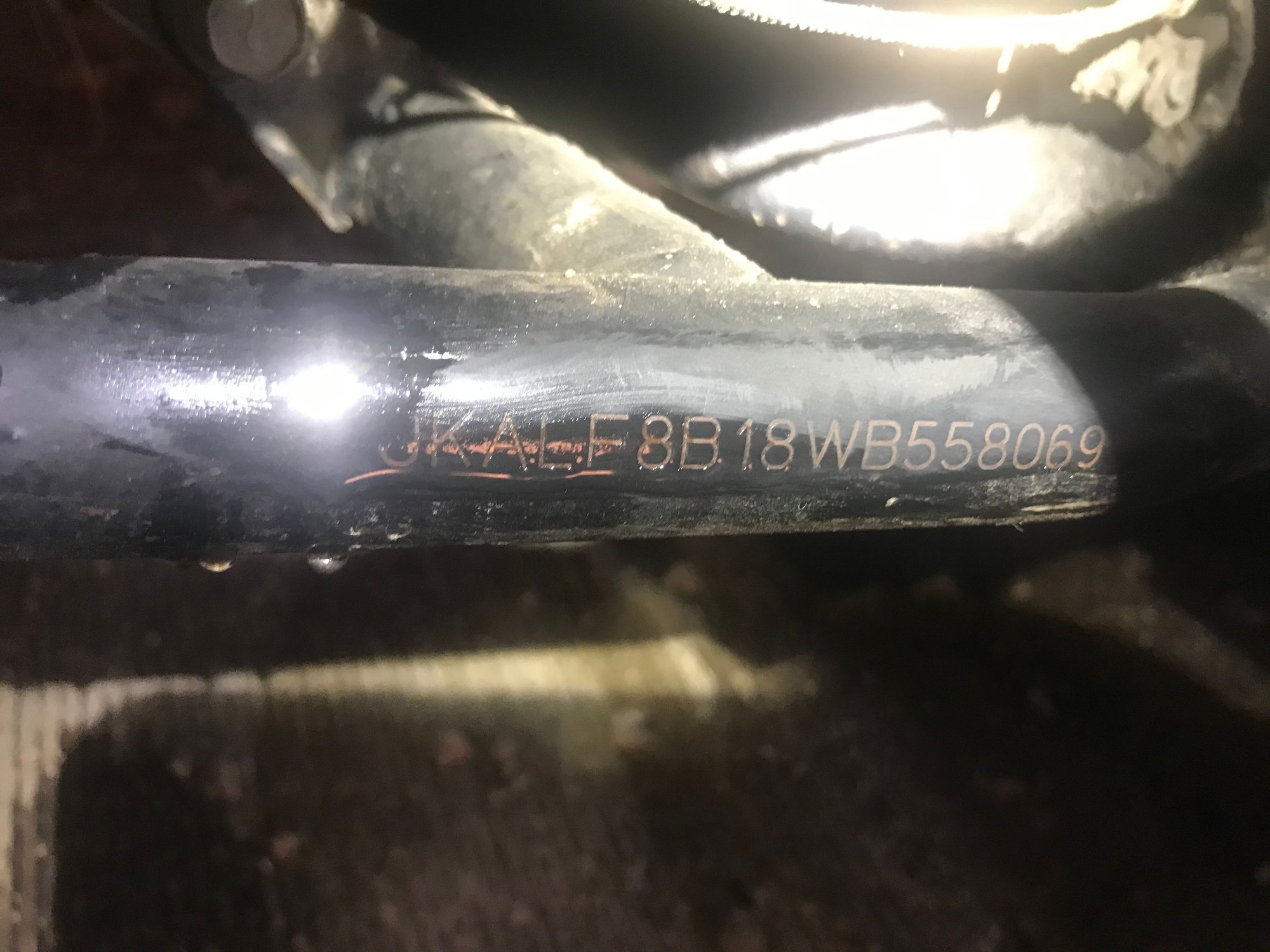

I’m new to owning a bike. I purchased an older Kawasaki bayou 300. It needs some, okay a lot of work. The problem is I don’t know what year it is. I’ve looked at the year guide posted on here, but it doesn’t make sense to me. Below is a pic of the VIN. The bike has side by side headlights
let me thank you in advance for helping a new guy out.
VIN NUMBER

Welcome to the forums.
That would be a 1998 model.
