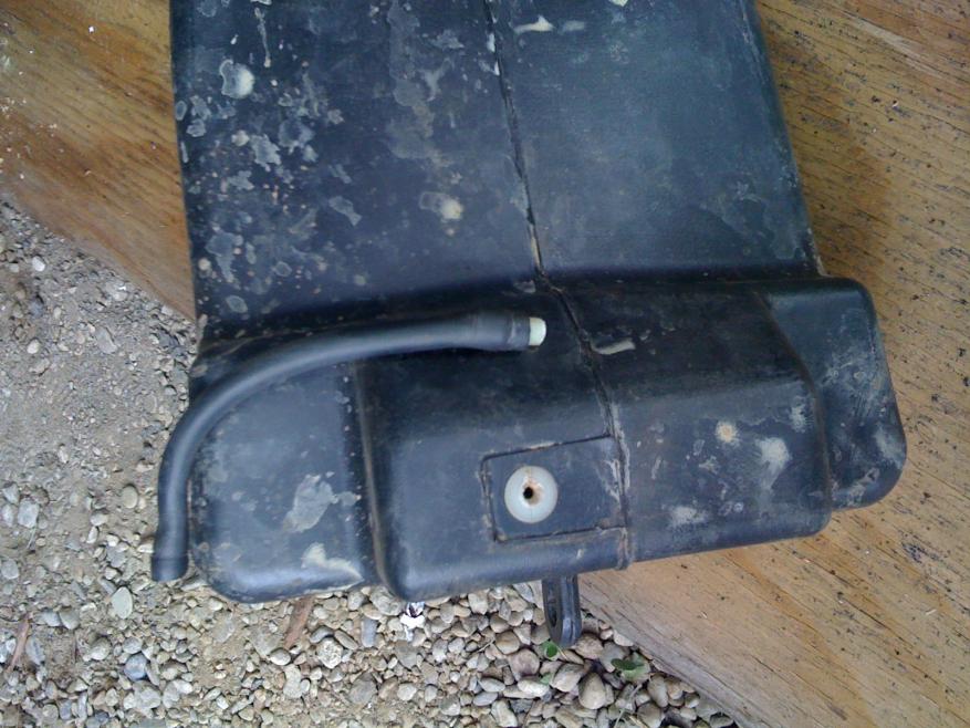

I tried to replace the fuel filter on my son 's atv and ended up breaking off the drain of the gas tank. It seems to be screwed into the tank, and sealed. I am hoping that this is replaceable w/o buying a new tank. Any suggestions on removing/replacing would be appriciated.

I would try getting a 1/8 pipe tap and tapping the gas tank..also get and a 1/8" pipe fitting that has a hose flange that matches your fuel line...
