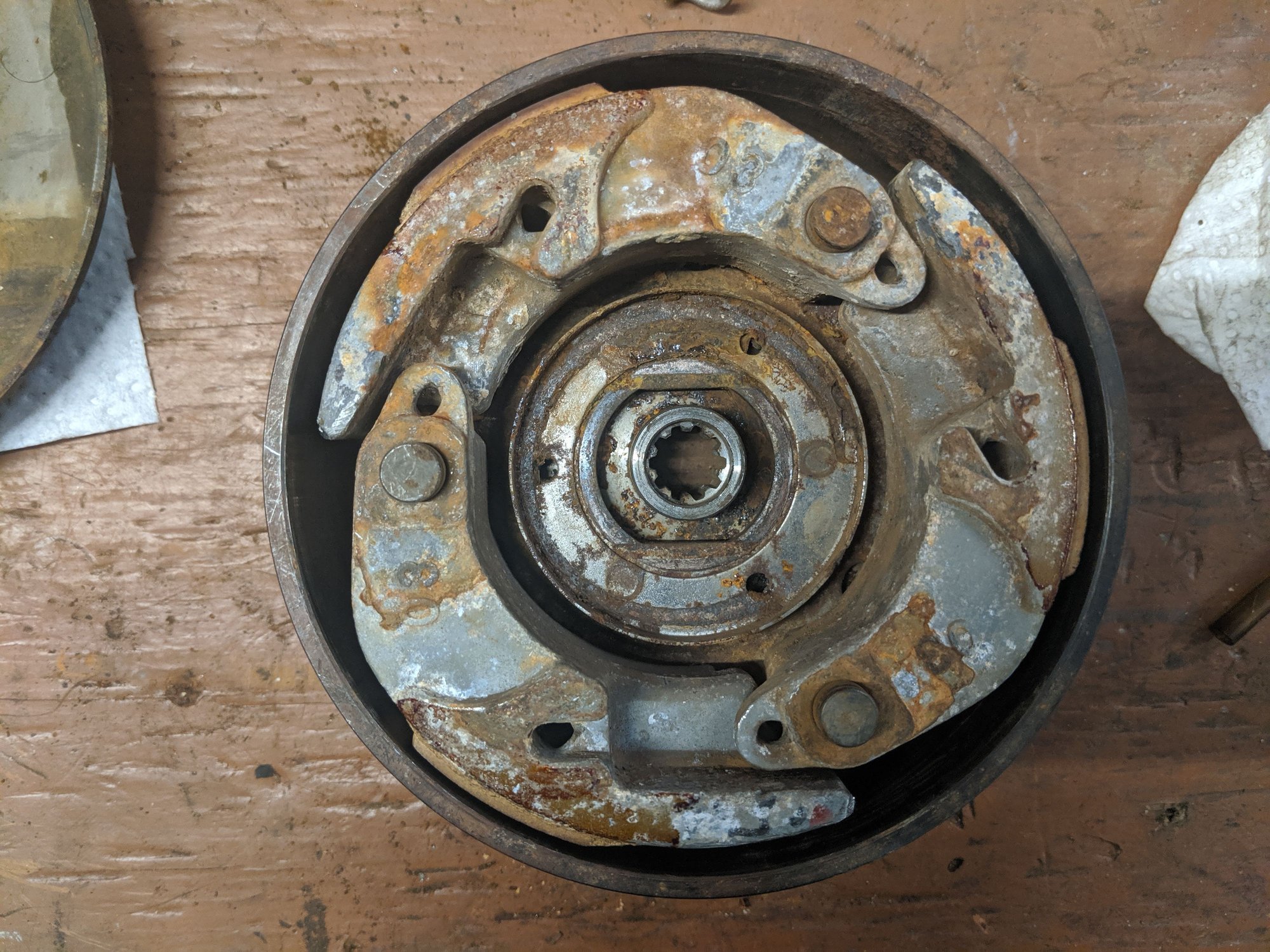

So I got a little curious and wanted to see how close the shoes are to the drum. And. Any other set up like this I've taken apart there's a decent amount of room between the shoes and the drum itself. The picture below, there's almost no room at all. Is this correct? Or is the drum not the correct one? I took the springs out just to see where it sat.

The shoes/spacing is fine.. BUT, You still have the drive hub (thing with splines) stuck to the clutch hub. Drop that on the floor and get it to fall off. There will be a fiber disc under it. All that has to be free.
I'd suggest looking at a dealer parts fiche so you can see the parts and how they go.
PM me w/address and I'll get you those springs.
