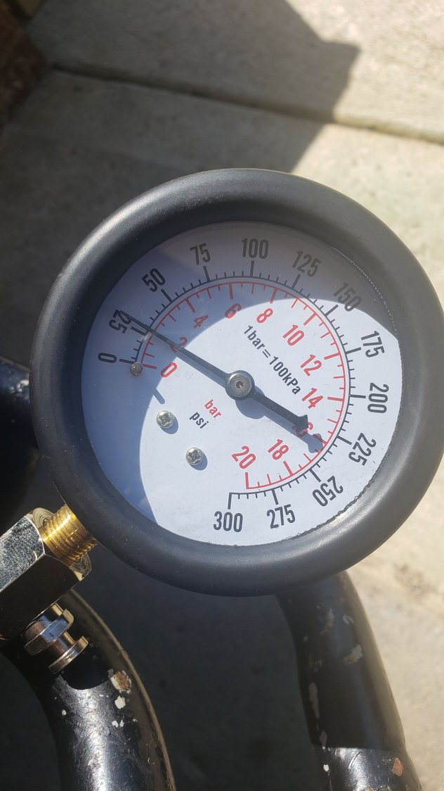

Default I think I found the problem

It only has 25psi of compression. What would you recommend I do.
Old Apr 6, 2020 | 07:28 PM
LT80's Avatar
LT80 Expert
Joined: Mar 2001
Posts: 8,340
Likes: 33
I'd get your oem cylinder bored to a oem piston.
No more Wuhan specials.
