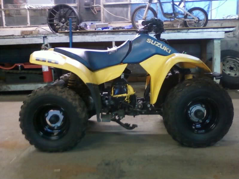

here is my 2001 i just painted last week
and here's my other son's 87 when i had it apart last year. sprayed the hubs with a silver caliper paint and rims black, made a nice contrast
