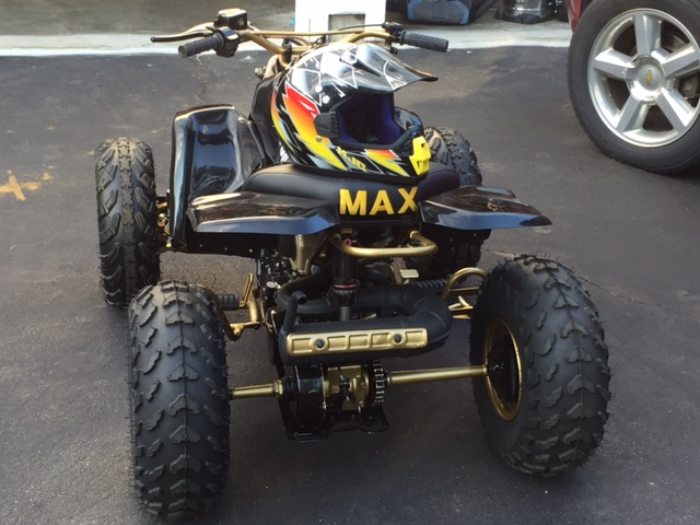

So...It's finally done! I transformed my boys '88 LT80 into what I thought and LT80R should look like:
  • Moore motor/carb/intake/head/clutch
  • Fox Racing Floats all around
  • Custom front end ('86 LT250R a-arms, disk brakes, hubs, wheels)
  • Motor/swing-arm bracing
  • Rear carrier mod (to accept Fox Float)
  • All bearings replaced (motor/transmission/axel)
  • Powder coated everything
  • Custom embroidered seat
  • Meier plastics
My son took it out for a spin and his comments "it's way faster than before, easier to turn and I caught some big air and it felt like a pillow on the landing..."
Job done...

Jack - he is sooooo thrilled with it's ridiculous power punch! It leaps off the line and screams to a blazing top end!
