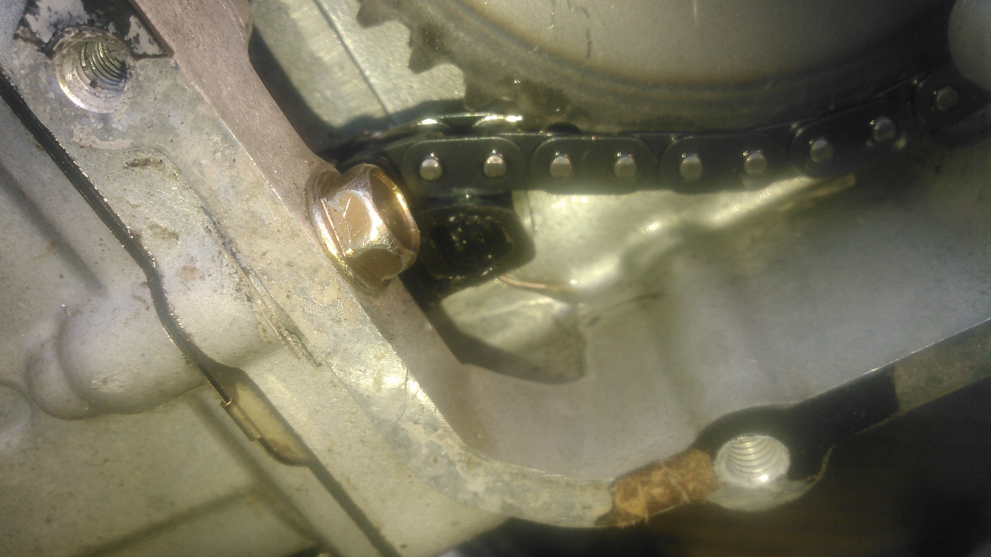

so i got to the installation of the tensioner and rand into a problem..i think..the chain guide should be down resting on the cyl. and head correct?..if so, where did i go wrong and can it be resolved without taking the head back off??
You can leave the head on,but probably need to pull the flywheel and stator to be able to get the tensioner guide into the slot by the crank shaft.And yes it's supposed to go back in the cylinder before you install the head.

i pulled the recoil and the nut was just stripped, riding around in there smh..the key and wheel are still in place thank god.....you think i could tap it down without taking that off?
Old Oct 3, 2015 | 06:34 PM
  #36
Don't really know as I always installed it before I placed the head back on,plus it's got a tab that fits in the cylinder cavity if I remember correctly..Might still be hard to do with out removing the head..
Old Oct 3, 2015 | 06:35 PM
  #37
1ArmBandit's Avatar
Joined: Jan 2013
Posts: 440
From: quad cities IA/IL
yeah i thought i had it popped in...guess not
