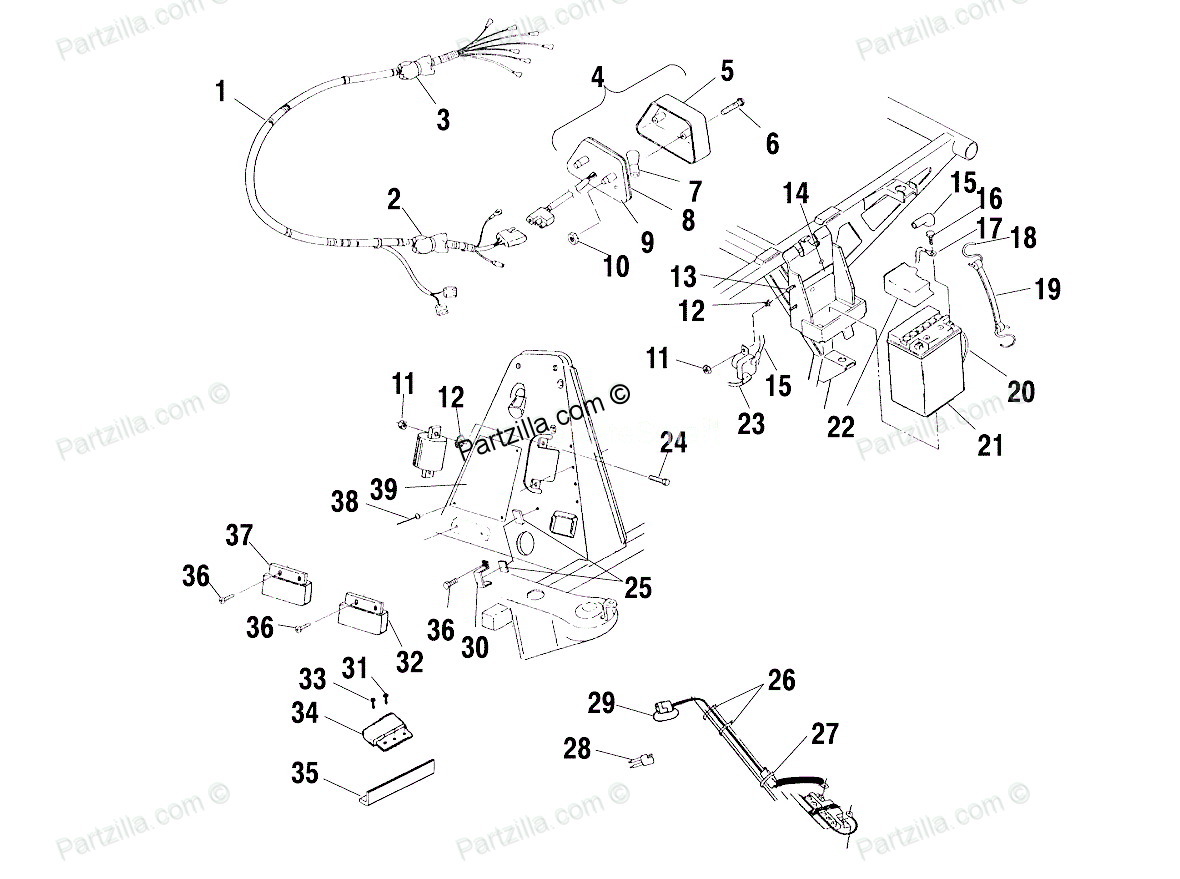

Your model has the terminal board in the center. All you do is trace the gray shift switch wire to the board. Unplug it and insert it in the red/white terminal section.This should allow the awd button to work. On the throttle cable you can check it under the panel also for any binding.If you ever run into me just buy me an iced tea.. Terminal board is item #39.
I got one culprit out of the way - the throttle was sticking because of some ugly aftermarket grips that were making it bind. I jerked them out of the way in a hurry.
The gray wire thing is giving me a fit, though. I am trying to follow any wiring from the shifter but I see and feel no wires whatsoever. Under the hood I see bigger gray wires that lead to the 2 terminals that I grounded the brown wires the other night. Those 2 blocks have a bigger gray wire coming into each one and a jumper gray wire to each other.
And I'm sorry - is the terminal block on the left here in the photo? I see a white and red striped wire on the right but just a solid red on the left.

Look to the upper left of the items in your pics that show the wiring from the stator to the cdi and coil. If you have the 2000 model should be a terminal board I showed on the thumbnail pic.There you can find the wires that run from the board to the gear shifter switch.
