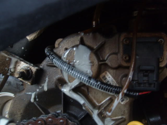

this happened after just five min of riding around the yard. noticed this leak coming from one of the plastic tubes coming from either carb or case??? cant tell with out pullin it apart.
its a milky white fluid? any one heard or had this problem? any help or info would be great...
not sure if did picture right to come up but also have it in my photos page

just another pic of the problem....

that sure looks like water in your oil....
Did your machine freeze? does it have antifreeze in it?

I have never seen such a thing, what fluids in a bike would be white??
thats weird
Old Dec 2, 2008 | 05:29 PM
700 sportsman's Avatar
Joined: Jan 2008
Posts: 1,841
From: NE Ohio
Default NEED HELP
that would be severely milky oil, but thats about what is has to be

never froze as far as i know just checked and has antifreeze in it.
its always had just a small leak from drain plug but always looked like oil. not sure what going on here what would cause sominthing like this?

Check your oil dip stick and see if thats where its comming from. Water+oil = gray milk. Water cause the oil level to rise and the excess blows out of the crank case vent hose. Should be more in the air box also.

what are some things that would cause water to get into the oil?

Deep water crossing,the crank vent hose goes to the air box,if the air box gets water into it the water will work its way down the vent tube into the engine oil.

driving in some deep @$$ water
