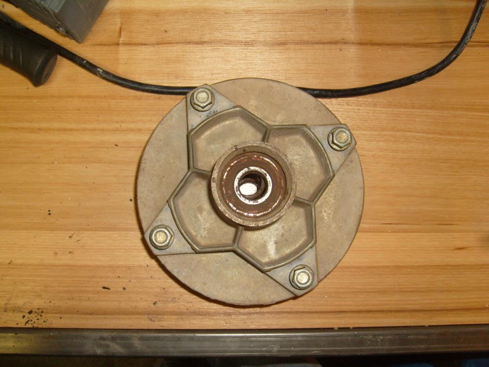

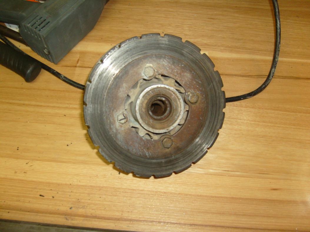

can any one help with any tips or tricks to getting out front wheel bearings in the hub on a 2000 polaris scrambler 400 2X4....... i figure there is probly a tool to use? would a heat gun help? but hoping theres a way around that. any advice on this would be greatly appreciated

someone on here told me for ball joints to heat the housin and freeze the ball joint to get them togther... worked great. can you do that with bearings too?????

well i went ahead and did the heat gun trick.... in to much of a rush to wait on a tool just heated the wheel hub and beat the bearing out from the back side of it and they came right out. put the bearings in the freezer for awhile and heated the hub back up a little bit and the bearings droped right in.... it worked out really well! and saved my self a lil cash from buyin the tool
