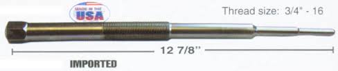

Yea that's popped out lol. Will I need a special clutch puller to remove mine?
Old Feb 4, 2017 | 03:41 PM
  #24
Yes either need the designated clutch puller or a bolt from a hardware store along with a piece of round bar stock.
