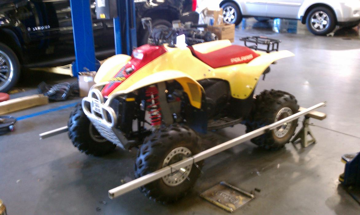

My 04 is starting to eat the middle of the right front tire. (not eat its gone) Any thoughts on why this would happen? The left side is wearing fine but the r/s is shot and showing signs of cuts in the tire in the middle. I'm not sure if its the toe in/out or not. I would love to go back to the Rawhides that were on it but I cant find them and the Carlisle's that are on it now are decent. Let me know. Thanks

Jack it up and see if any excessive play in the a-arm,ball joints or tie rod ends. Even worn strut cartridges /springs can affect tire wear. Easiest way to align the toe out is with a straight wood or metal stud. Have someone hold the bars straight while you have the stud against the rear tire and you can tell if toe out or in is needed. Here's one guy's method.
