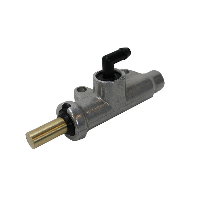

How do I bleed the brakes on my 2002 polaris scrambler 500 HO? The rear brake does not work and I need to bleed them.
Old May 21, 2016 | 07:52 PM
You can try a mityvac on the rear caliper bleeder and see if it helps bleed the rear brakes. Better than trying to hand bleed one. Most of the time it's the seals on the small rear master cylinder that have dried out and suck air from non use and it can't build up pressure. Seal kits are available for around 25 bucks if needed. Polaris Scrambler Rear Brake Master Cylinder Seal Kit 125 | eBay Even after market master cylinders are on ebay now for about 45 bucks versus over 110 bucks for an oem m/cylinder.
