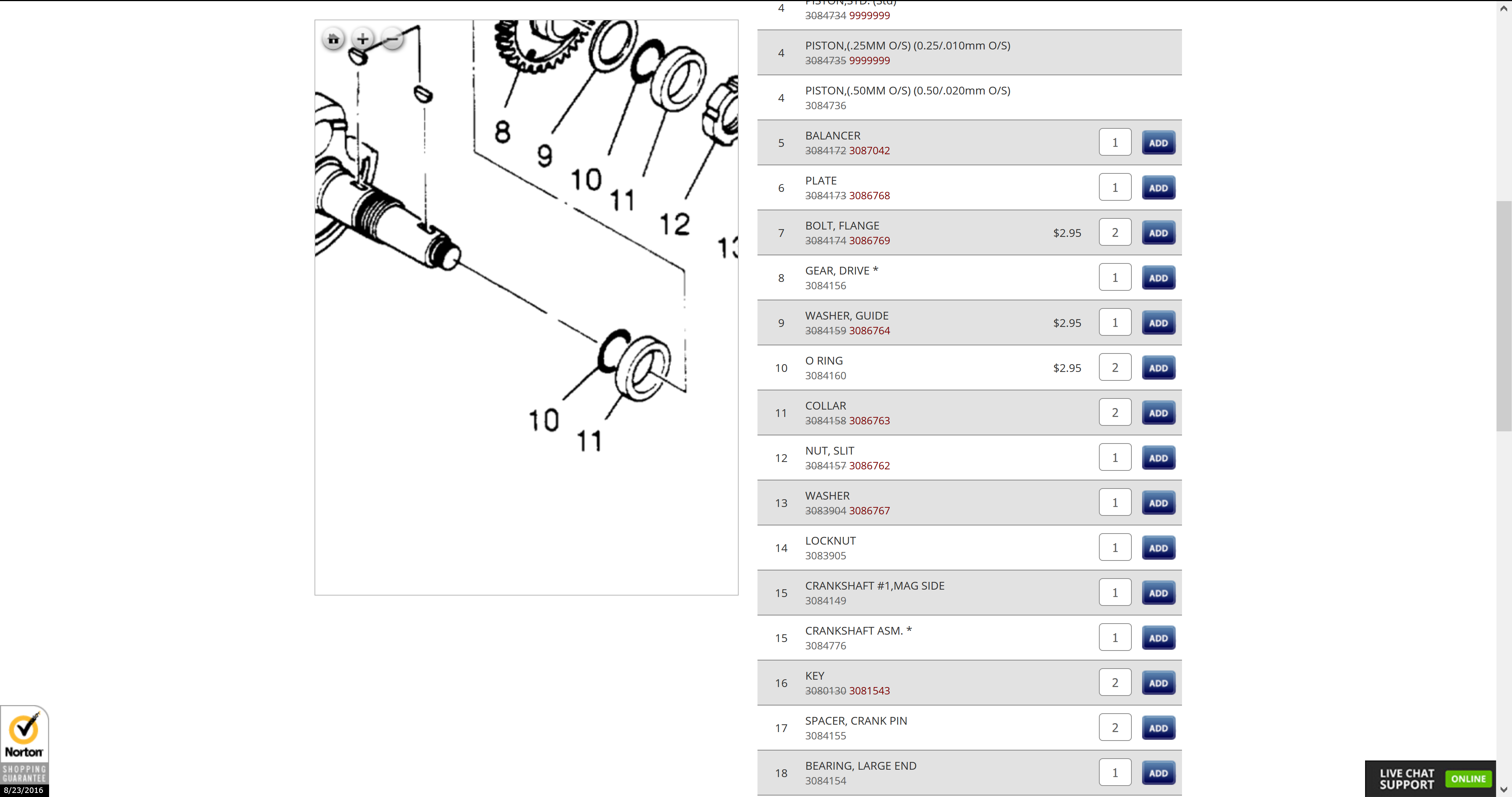

okay so im in the process of putting my atv back together right and im stuck a little bit, u see which way does the collar go on it is number eleven in the image is it with the flush end toward or away from the engine u see it has a tapered end ( if that what u wanna call it) also and im not 100 on which way it should go.

It's ben a long time for me since I tore into my scrambler...from the pic it looks like any "tapered" end would be facing in...just going by the diagram mind you...
Old Aug 23, 2016 | 02:32 PM
  #37
Tapered end against the o-ring on the crank shaft. This is just to slow down any seeping back and forth through the seal.

okay thanks guys thats what i needed to know, it has been like 5 years since i tore this far into her, for some reason i thought the o ring went on the outside until i noticed there were 2 o rings and after looking at the diagram.now just one more quick question(at least for now) is it okay that the bearings have a bunch of rust on them because i took the engine out like 2-3 weeks ago and started to take off the outer half of the crankase u know where the stator and flywheel goes and didnt quite get to take it all the way apart but i did loosen it enough to get all the antifreeze out but in letting it sit for so long the most outer bearing of where the stator goes is like seized up from all of the rust. will this break loose when i get it all put together and run it a little bit. also is there some sort of tool out there to help take off and install seals/bearings.
