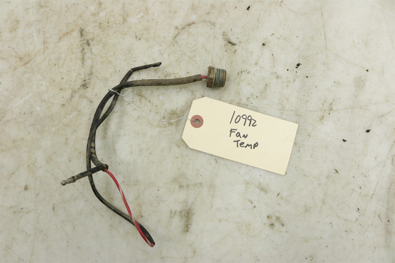

If the fan comes on when you turn the key on, the switch in the radiator sensor has melted and powers up the fan. Sensor need to be replaced. You may have to splice your wiring into a new sensors as most will be just a two pronged type replacement,no wiring harness.The pic is just an example of a sensor. If the hot light comes on,you may still have trapped air in the system.

Bleed with engine off.. Make sure all air bubbles are cleared before you close the 10 mm bolt. Item 30 and the sensor pic is one and the same only yours has the harness built in. It's what triggers the fan when the temperature is around a 175 degrees. Here's a pic of your old sensor. Just make new spade connectors for the replacement switch.
