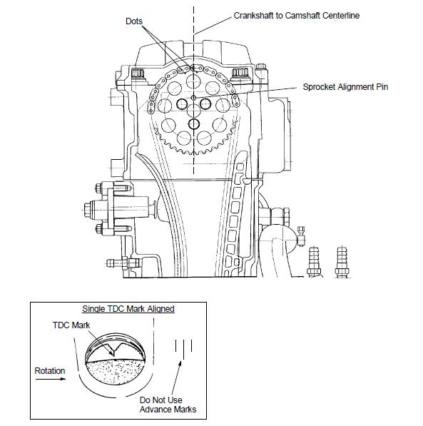

I was also wondering that if my timing was slightly off if that would give me issues. I checked my timing by taking the bolt off of the flywheel cover and turning it over with the pull start so the timing marks were showing. I then took off the cam shaft cover and there was a line on the cam shaft gear that was parallel ( vertical ) to the cylinder and piston. I assume this means that my timing is correct

Should look like this at tdc.
Attached Thumbnails 1997 Polaris xplorer won't turn over-2011-05-21_125845_00_polaris_500_cam_timing.jpg

I DO believe that little spring is installed correctly for that detent shaft but I'm going to tear everything down again and regain access to the valves and detent and spring and cam and reverify the spring installation just for grins.
My first initial through is that something is slightly off with timing where that compression ball isn't hitting the rocker at the right time to release that pressure .. I THINK.. that is just my initial thought.. I know Old Polaris Tech helped me the past with few other issues with some other 4 wheelers but this one is mine and I'm trying to get this fixed now. SO, I have saved the image that Old Polaris Tech posted about the timing alignment, that will be VERY HELPFUL to check but right now my main question is about the compression release ball on the cam. IF everything is supposedly in line with timing, shouldn't that compression release ball hit the rocker the right time to release pressure to allow for easy start?
I don't see any reference to where that compression ball is in relation to the alignment of the timing. That is were my disconnect is at the moment.
