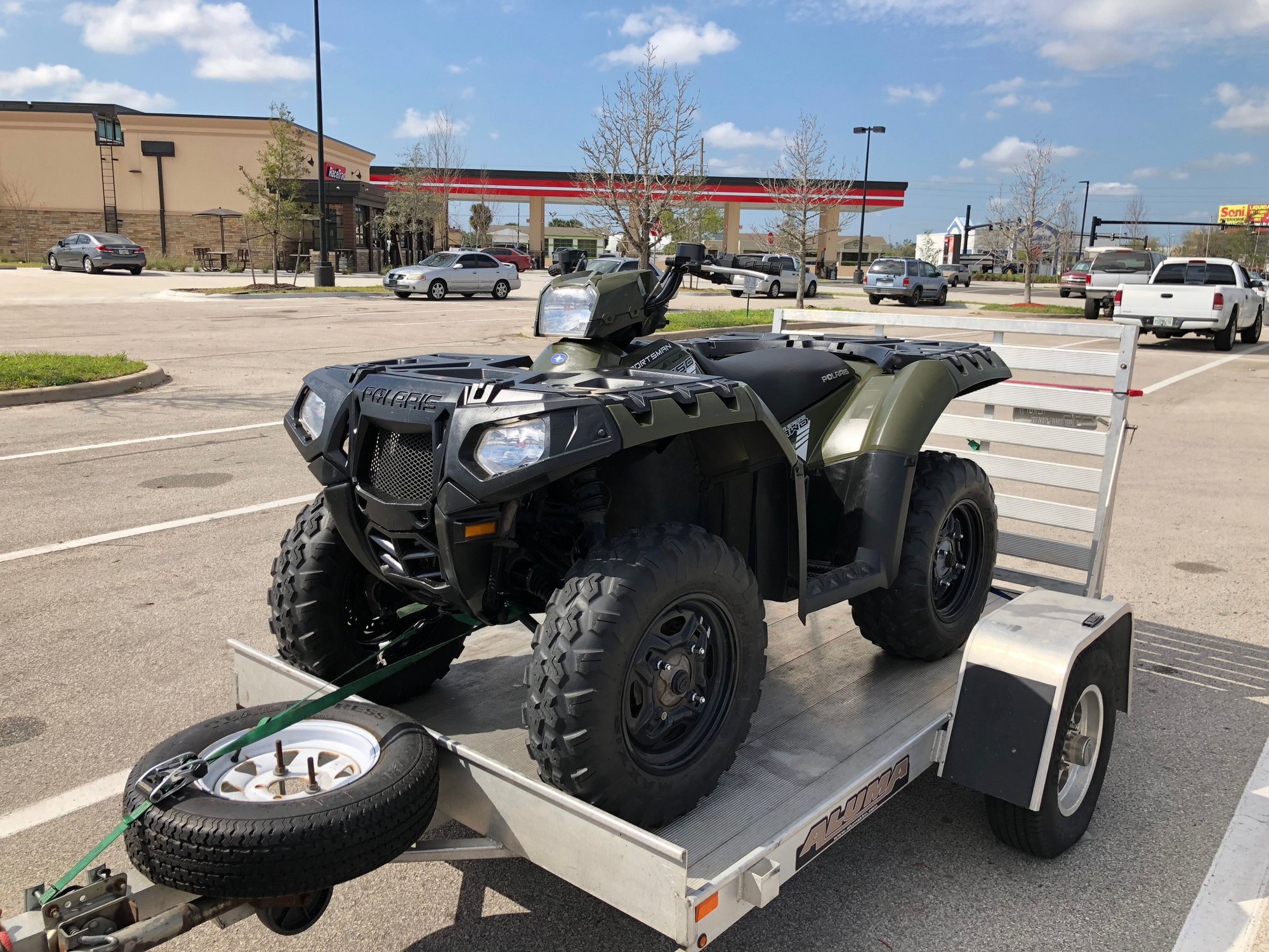

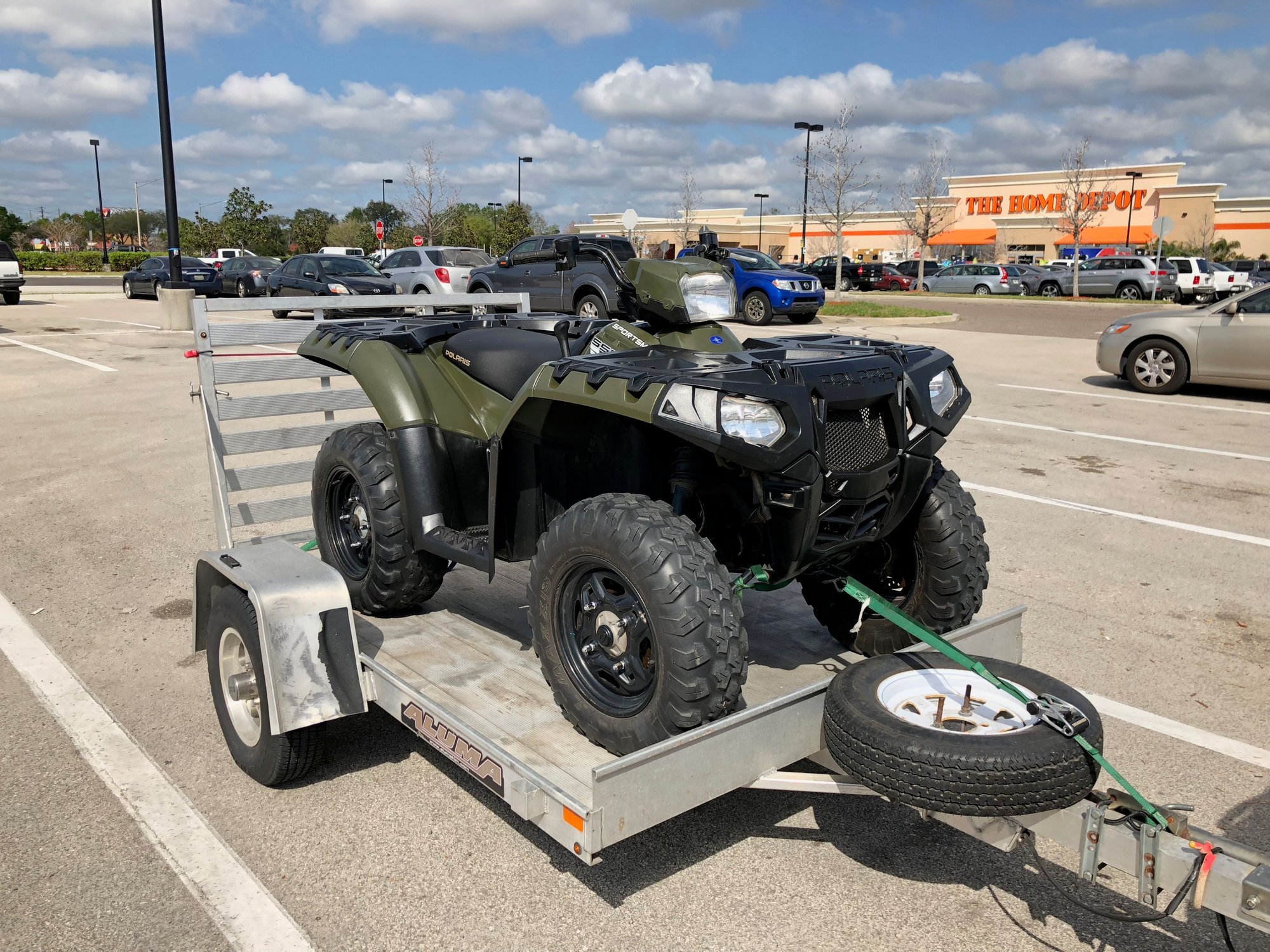

Today was the day. I ended up purchasing a 2013 Sportsman 550 EFI. It does not have EPS, but I am ok with that. I have the clean title, so that is great!
Its in really great condition, decent hours/miles. See pics below. The tire will need to be replaced eventually, but they have some tread left. The one thing I found, which I am confused on is the Speed0/Main Headlight plastic housing that secures to the handlebars. It seems to be somewhat loose. I would have thought it should be securely attached the handlebars so it does not wiggle/bounce around. Any ideas?
Congrats on this very clean looking 550. Looks brand new,not almost 5 years old. Upper and lower headlight pods are secured to a bracket on the handle bars.Headlight has a couple screws and thick o-rings to secure it in place. Designed to be mounted like this to help on vibration and in case of a wreck the pod would give and not the bars,supposedly. Didn't always work out that way though.Again a good looking 550. Hope it gives you years of service.
Thank you Sir! I did take the headlamp assembly apart and noticed that the 2 lower tabs that are screwed to the brackets on the handlebars were both broken. Thus it really only being secured by the single screw that is next to the ignition switch.
None the less, I ordered a new lower pod panel, and all will be fixed!
