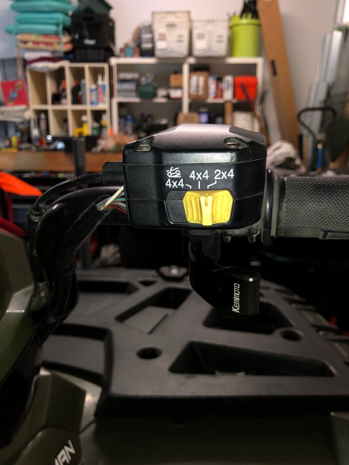

Thanks Harley! Here is a pic of the handbar switch, it looks like it is similar to your 16 850, where there is 4X2, 4x4 and 4X4 ADC. Let me know what you find on the wiring diagram. Today, I will drop it from the jack stands and take it for a drive and listen to see if it is still engaged.
That is what mine looks like yes. Some other ADC models machines only had a 2 position switch.

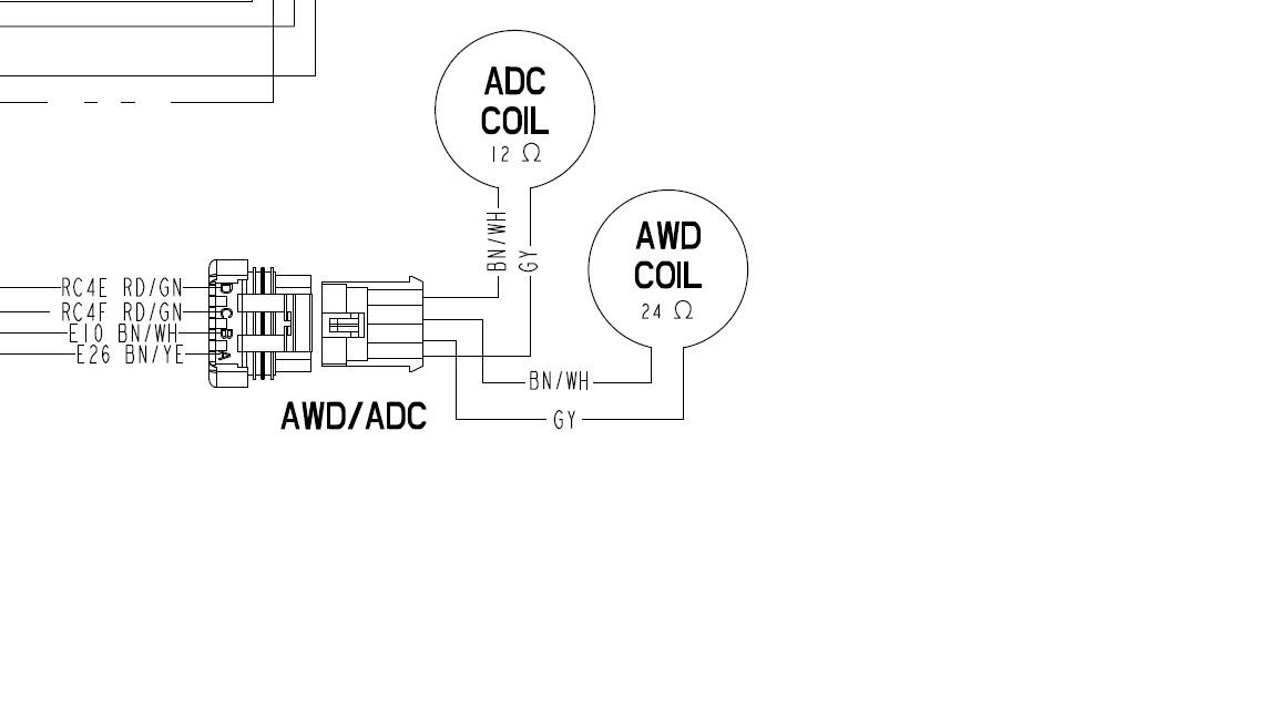

Anyway according to the wiring diagram, on the front gearcase, there should be a 4 wire plug coming out of it. Remove the Brown/white and the grey wire from the gearcase connector and go test drive it and see if the problem goes away.

There is a possibility that there is damage to a component in the adc portion of the gearcase too, so removing the wiring may, or may not, take care of it. You may have to disassemble the gearcase, but dont do that yet.
We had to tear into a gearcase a few months back to get the problem to stop. The customer didnt want the ADC function, so we took components out so it cannot ever go into adc(he had the 2 position switch) Looking back at it now, honestly I THINK if he would have replaced all 4 tires at the same time(not just the rear tires, like he had changed already) the problem may have gone away. My thoughts is the difference in tire diameters made the adc to engage when it shouldn't be. Cant verify this would have fixed it, just a thought of mine.
