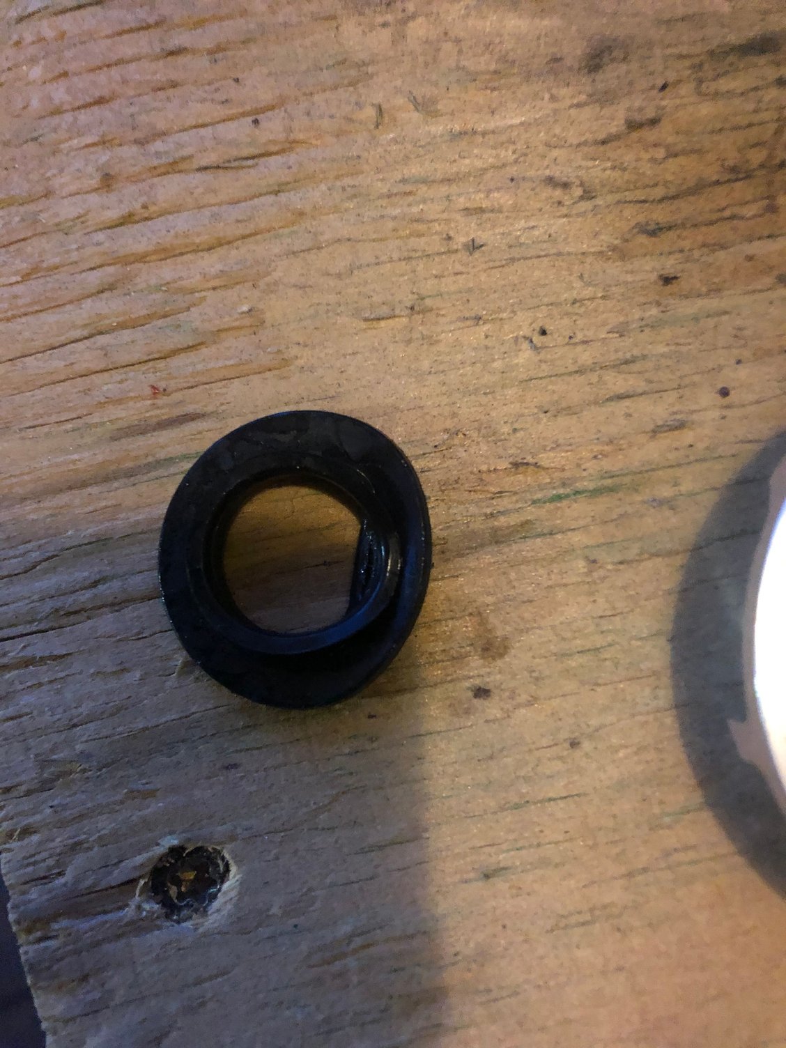

Well I started to takes thing apart to redo the work and I came a crossed this whole taking off the water pump . Should I just replace this or the mechanical seal and the oil seal .

well if you flash the ecu, at least you can rule that out. if the other seals look fine then why replace them, but your call. good luck. and thanks for posting discovery.
