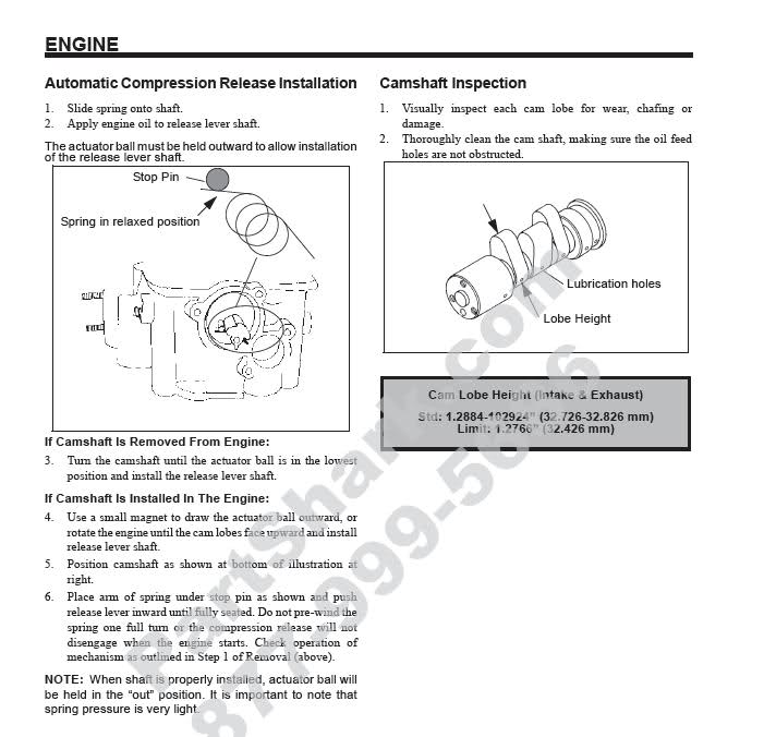

Check that the decompression device spring is set right and the actuator moves and flips back. If you're not careful when you install the cam the spring and actuator can slip out of place. Double check that you have the cam chain in time with the flywheel tdc mark and that the cam sprocket alignment pin is dead center of the head. The smoke could be coming from exhaust pipe gasket at the head or an exhaust pipe donut could be worn/leaking at the first joint of the exhaust pipe that held by the springs.
spring was good as well as timing. Rocker arms were so tight that they wouldn't budge at all. Loosened them up and the quad started. What would make the rockers so tight?
