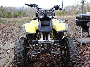

Ok here's some pics. I'm also having a hard time knowing (remembering) which way this lever on the carb is choke is it up or down? It ran great surprisingly this morning with the lever up which i'm hoping is without the choke on. In this pic it's flipped down so I could get a better picture with the camera. No Youtube video just yet working on that been busy today. Also want to say this thing doesn't smoke at all, has great compression & all that. Also it's got a weird problem where if you dont turn the gas to the off position it has a slow drip from the bottom hose on the carb what's up with that?
Might want to post this in the yamaha section. First of all you want to pull the carb, clean it and see if it has been rejeted for that White Bros slip on. Sounds like the float in the carb is sticking so it would flood and leak. Looks like she had been rolled. Must be hard to ride with the handle bars like that.
Ya, those handlebars look messed up !! definately has been crashed/rolled, I would check for other damage.
