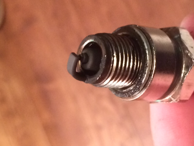

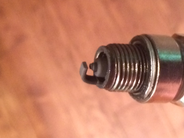

Thanks OPT. Ok so I drained the gas and removed the carb and cleaned it again. I'm not sure about the fuel screen you mentioned in last post so please let me know where to find it as I think there is a fuel flow problem. I put it back together and it fired up after some priming but same issue. Misses and hesitation/backfires. So I put it to half throttle and let it die. I pulled the plug and it was very dry. And lots of carbon as you can see from the attached pics. This is a brand new plug.

No fuel bowl or screen to clean out on this fuel valve. Plug carboned up either from too much fuel or could be a stator related problem.I'd recheck the carb float level and if fresh fuel and a new plug doesn't solve the missing/hesitation then it could be a stator breaking down.Plus you mentioned riding in the rain/mud before it started acting up could have something to do with it. The stator cover slots just lets in gobs of water that can screw stators up.I've changed a bunch of these over the years because of water.Plus your readings especially on the black/red wire are not with in the 20% +/- allowed in the manual.
