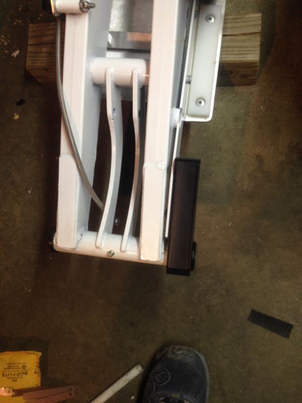

Hey everyone, just a little update. The rear end of the lt230 is done. I have elka shocks all the way around now. The top a-arms are powdercoated with the bearings installed. I'm waiting on ball joints from all ***** and for it to warm up to paint the frame and bolt stuff up.
