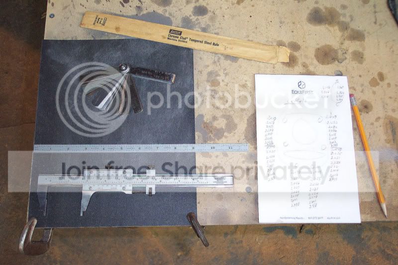

My milling operation.
Took about .050 off and have only a .001 variance.... The head gasket will take that up.
Compression went from 8.6:1 to 10:1. Much better.
The piston comes .014 above deck now. Add the base gasket (.020) and that leaves the piston .006 below deck. With the head gasket, there is .030 + .006 = .036 clearance to keep piston from smackin the head.
Here's everything you'd need to do this yourself: (large tub of elbow grease not pictured [img]i/expressions/face-icon-small-wink.gif[/img] )
