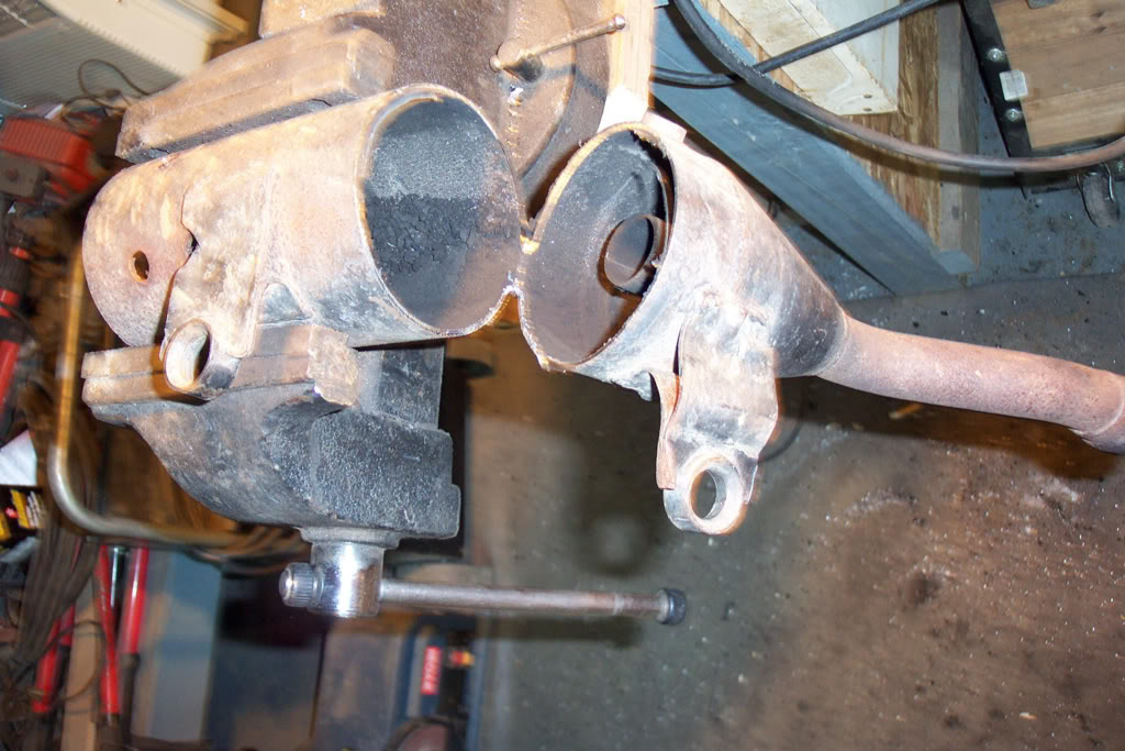

Alright, I got the pipe on there and it fits up pretty dang nice! I cut the head pipe off the stock muffler and welded it to the back of the supertrapp (yes I know I suck at welding) and bolted it on. Now I just need to get fuel figured out which will be a little tough since I have it at work and can't really take it out. It doesn't sound much different than my stock pipe. Anyways, here's some pics. Oh and it shaved a pound off the stock system.

Did you get the stock pipe to be about the same size as the pipe inside the muffler?

well that's the interesting thing I'm not too sure of. Since the pipe didn't come with the head pipe there wasn't any pipe in the back of the supertrapp. It has the large opening with a plate thats all drilled out. So what I did was I just left the drilled part of the stock header pipe on. I had to shorten it though. I'll have more pictures of the construction tonight, my camera died on me and I don't have the cord here at work.

Alright, here's some pics of the costruction
here's the backside of the supertrapp:
this is what I left of the stock head pipe, i had to cut the end off though.
And here's the welded couple
So I'm excited to ride it and see what else needs to be done to get it running like a champ. But I am quite pleased with the fit.

Wow, mines different. We both have 86's???
The exhaust having to find its way thru those little holes looks like it would be pretty restrictive! I'd knock out the end and make it open.
