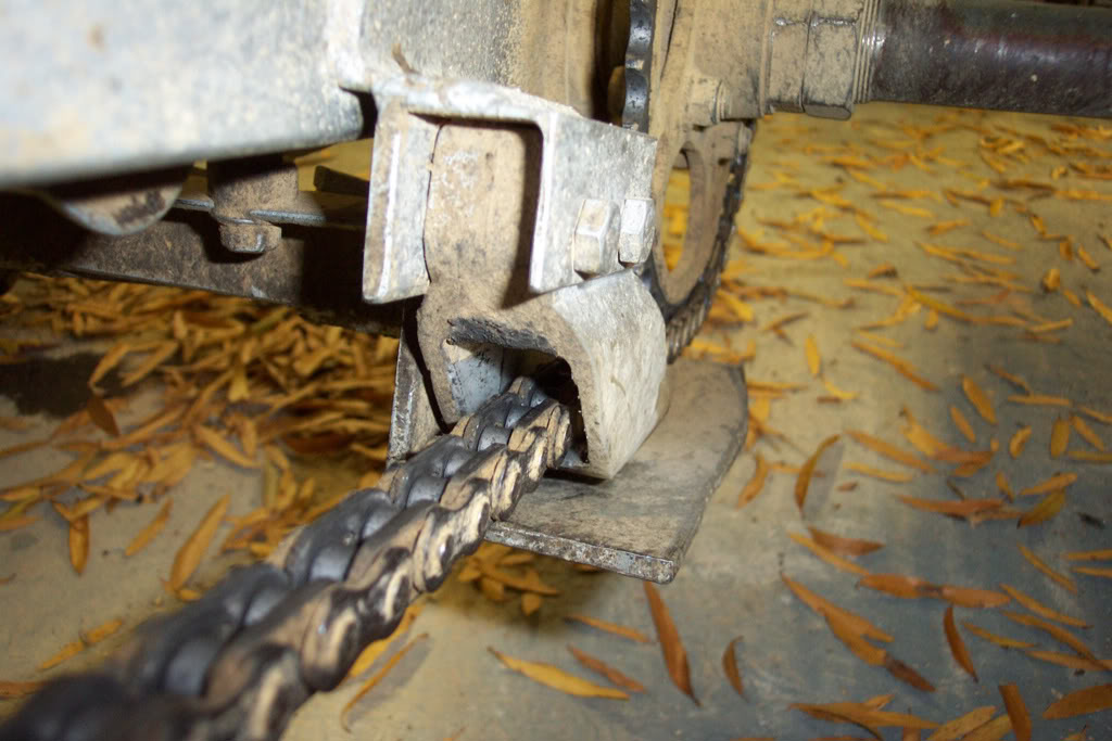

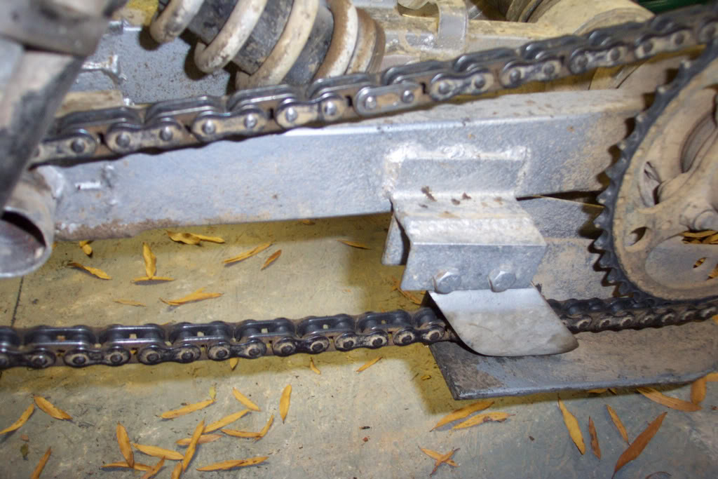

I told ya before I thought it was from an E. The dimple is to clear some kind of drain tube.
Forget the roller. 1) It doesn't guarantee the chain won't come off. 2) Its like riding with the brakes on... All rollers are. Get the warrior chain guide and weld up a bracket like I did. The chain will never come off again and there is nothing rubbing the chain to slow you down.

The drag from the warrior guide is negligable. I had the back wheels off the ground and spun the tires to see. Anything on the bottom of the chain doesn't drag with any force applied to it (unless in reverse or if the thing touching the chain is spring-loaded). Also, the warrior guide is long and slippery. So if the chain touches it, it just skims across it unlike a roller that goes "bam" "bam" "bam" as each link hits the round surface.
That red, spring-loaded roller I used to have was awful. It was literally like trying to spin the tires while lightly holding the brakes.
