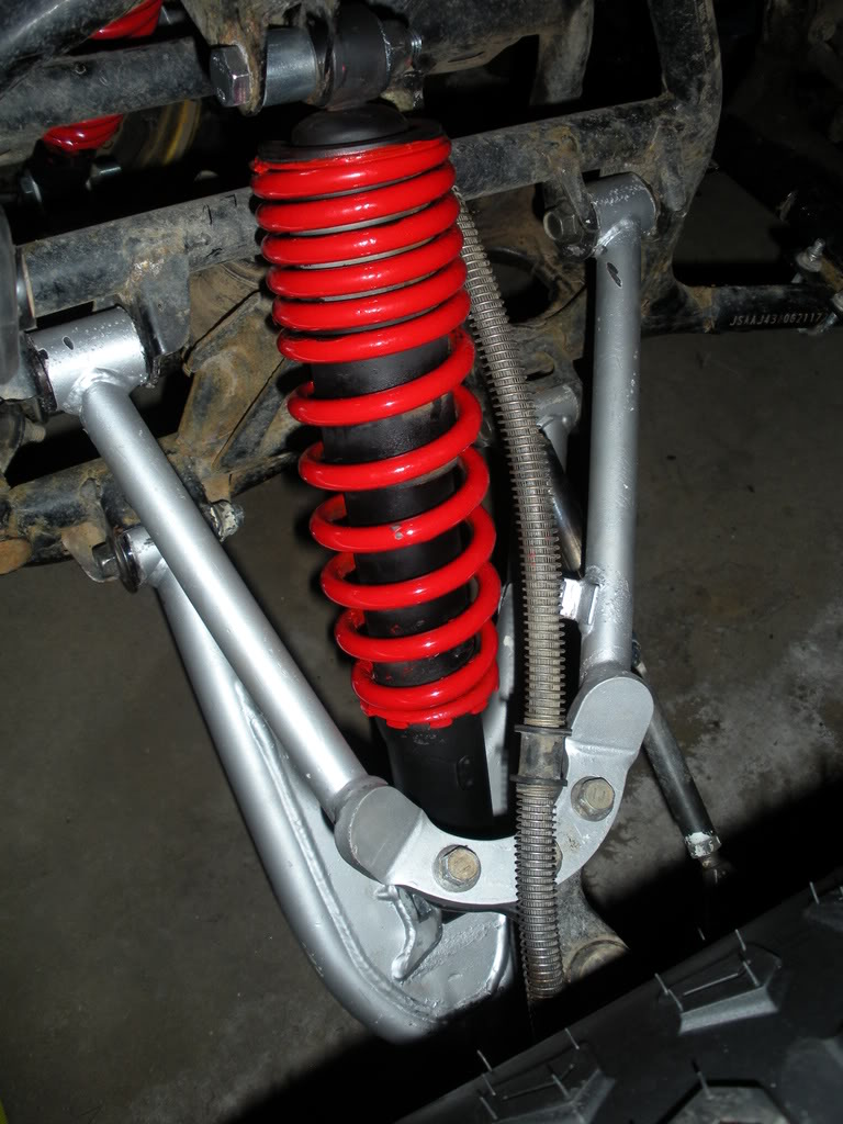

Old Apr 17, 2009 | 06:56 PM
  #67
atvman29's Avatar
Joined: Aug 2007
Posts: 2,071
From: Minnesota

hey, thanx alot atvman.
maybe you should make a little 1/4" plate bracket to move back the upper balljoints in just a bit to tweak ur camber... shouldnt be a big job at all.

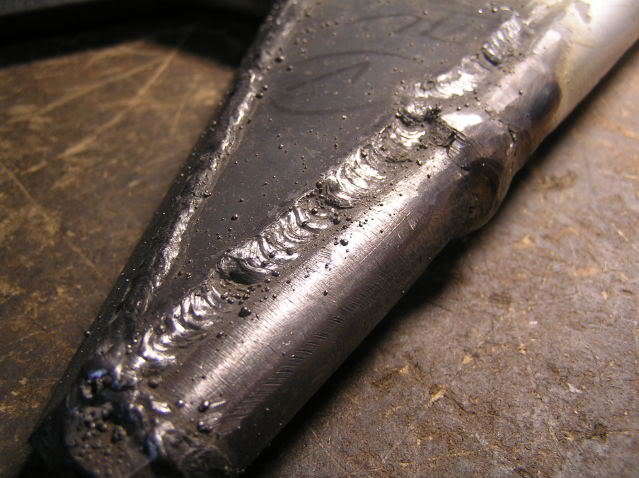

ok folks, got another update:
SERIOUSLY beefed up the arms (up to a whopping ~6lbs each!)
what??? decent welds from flux core??? wow, im startin to like my welder again! (just took alot of playing with the settings)
so, what do you all think so far?

Looks really good man! I'll come up with something to get rid of that camber.
