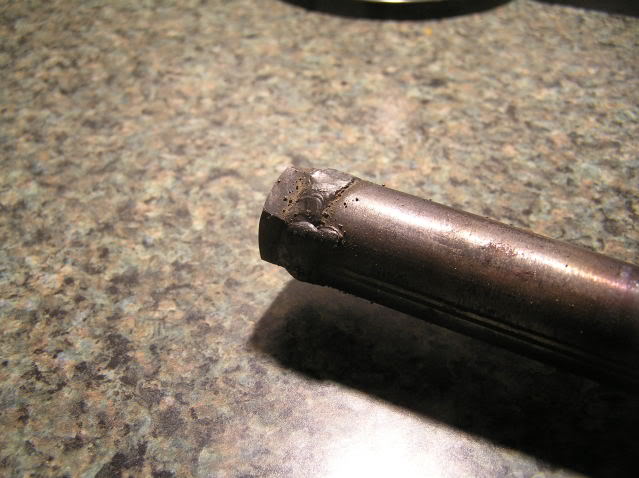

welded on the nuts today:
LOTS of bracing to come!
