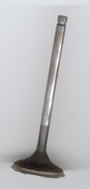

What condition is the valve stem guide? Is some kind of abrasive particulate in your exhaust? Could the seat and valve angles be different??? Is the valve lash set properly? Could the valve be getting so hot, the hardness goes away?
A typical intake valve: Name:  250valve1a.jpg
This picture is what my exaust valve looks like and maybe the valve is getting to hot what would cause that and how to correct it.

If the valve is getting too hot, maybe the lash is too tight and the valve isn't closing all the way. Once the hardness goes off the surface, it doesn't take much to wear it down like that.
