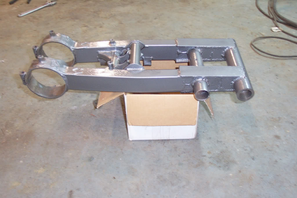

Originally Posted by hambone6988
got it figured out, i had to rplace wires comming out of the stator, and also the valve adjustment screw came out of the rocker arm.....grr but now shes running!! no i need to know hoe to get more width and length out of the little 230......any ideas on how to do that? or maybe a swingarm from another machine that will bolt up?
Cut n weld. That's what I did.
