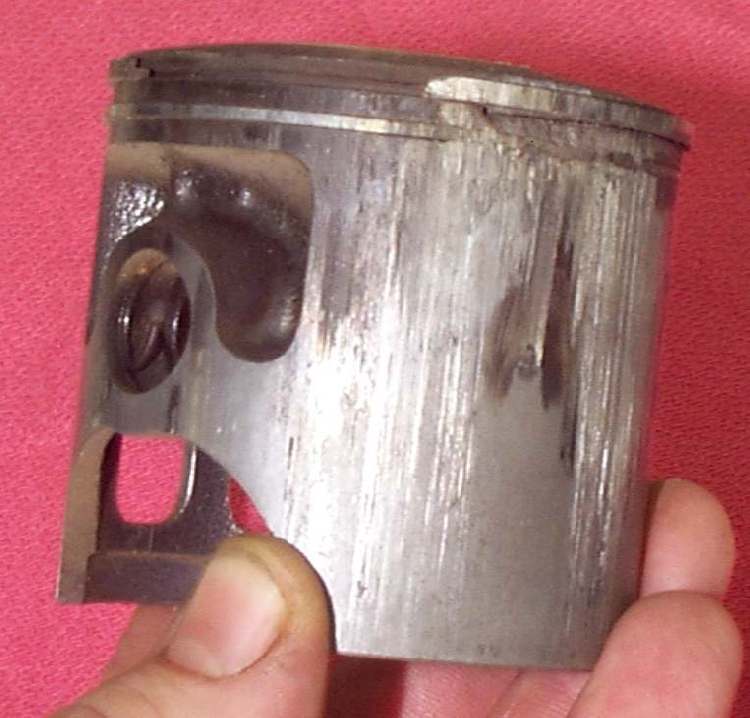

My piston failed (lean main jet) and a piece broke off (see pic). When I stopped I noticed an oil/coolant mixture was dripping for a few seconds and then stopped. I suspect it came from the overflow on top of the tranny. There is some also antifreeze and oil where the crankshaft is. I know this was the result from the piston failure as I often check the oil and it never had coolant in it.
1. Can anyone explain how the coolant got into the crank case and the oil??
2. It is my first time doing a top end, and i noticed it is already at 2mm over so I have to resleeve the cylinder, right? I'll go back to stock so I have room for cheaper rebuilds in the future.
3. I will also be splitting the case to clean out the inside of any debris that fell down. The rod has no up and down play and feels solid so i will be reusing the same crank, but i'm replacing main bearings and seals. When i put the cases back together, what is best to use: gaskets, permatex ultra blk, or permatex ultra grey?
Any other tips?

Sorry, I don't know how I left this out...
It is for a 91 LT250R. I looked up the piston number that was stamped on it and it was a 69mm, 2mm over the standard. That is the max size sold by wiseco, so I guess I should resleeve the cylinder.
And yes, I believe it was a fuel problem as well, this happened at WOT going 60+. When riding trails at slower speeds and throttle it smokes and spews oil so I know the pilot is sufficient. BTW it has a 39mm PWK.
