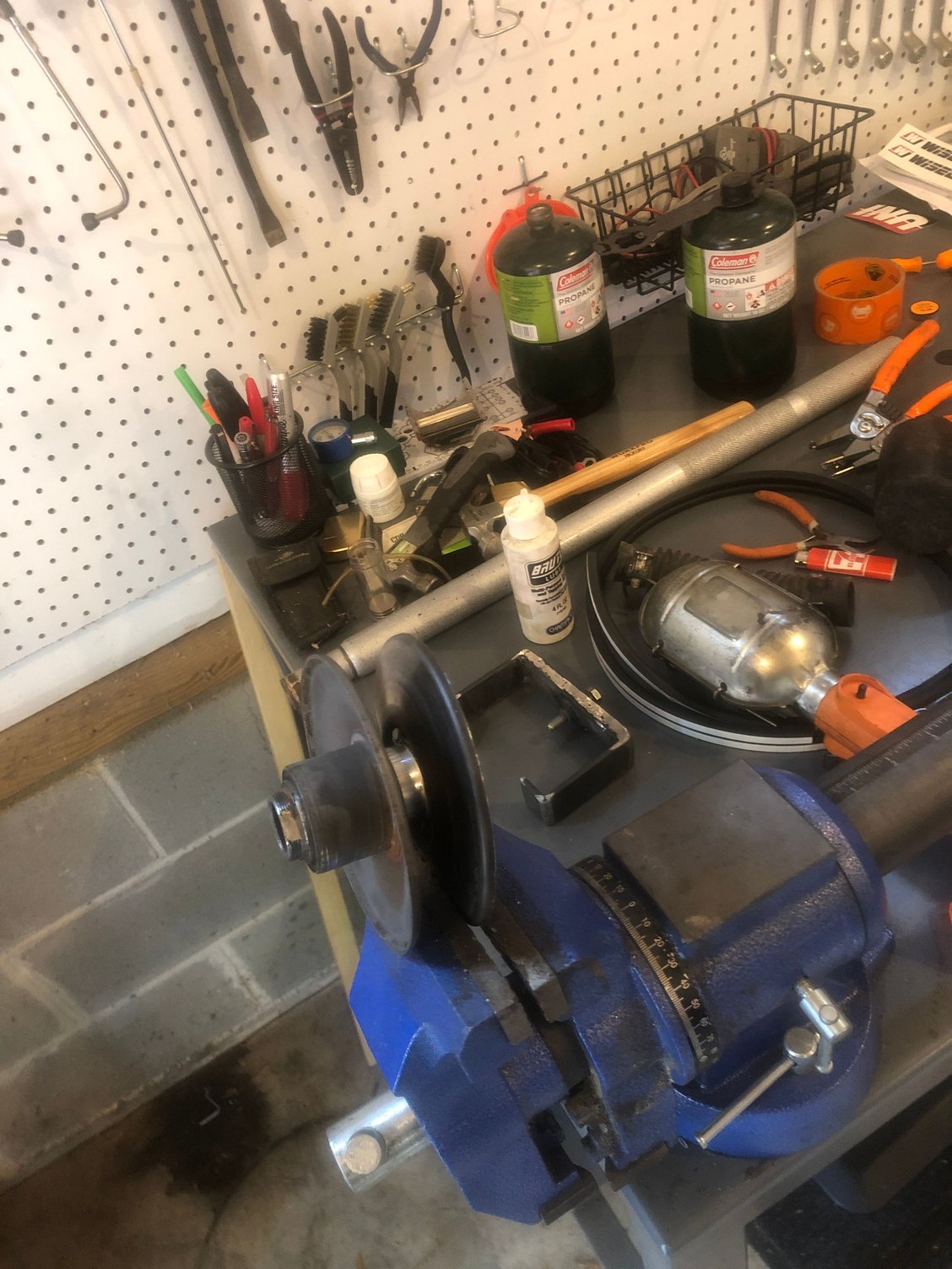

I’ve got the rear clutch out of my quad, I have to replace the fixed drive plate sheave. The clutch is all torn down except the moving sheave is still attached. It seems to be held in place by some internal pins or something.... does anyone know how to separate these two? Thanks!

Right after the threads there is a cover. you grab that and get it to move/spin. It'll come right off. It would be like grabbing a twist throttle of you get my meaning.
Make sure you check the bearings. They go bad.
Did you get the new fixxed face yet?

Yessir, turns out it was tack welded and that’s why it seemed like an unsolvable puzzle.... got it apart and all fixed up.
