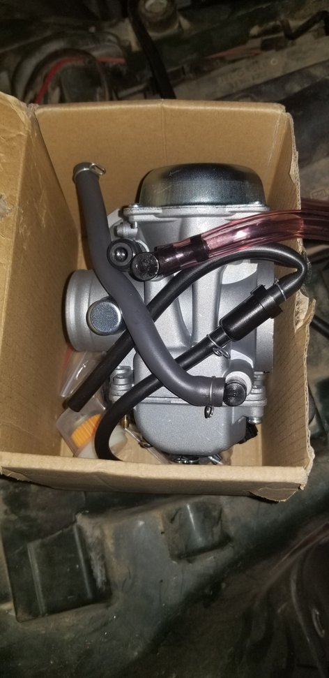

So I went with the "Chinese knock off carb" due to the cost. Can you tell me if the Pink hose is for the vacuum side of the fuel petcock valve?
Old Sep 22, 2022 | 02:00 AM
Posts: 7,506
Likes: 389
Don't think so, it will be the breather that goes upwards. As it has a fairly fancy pipe for letting fuel escape from the float bowl, (the black pipe with plastic valve in the middle, route it downwards), I would guess fuel will run down it if the float needle sticks open. So, leave the vac pipe to the tap disconnected, run the bike on PRIme and see how you go.

So I put the carb on and it started right up, I did not make any adjustments and took a short ride down the road and It seemed to be just fine, maybe the idle was abit higher than normal but seemed ok, Hope that helps
