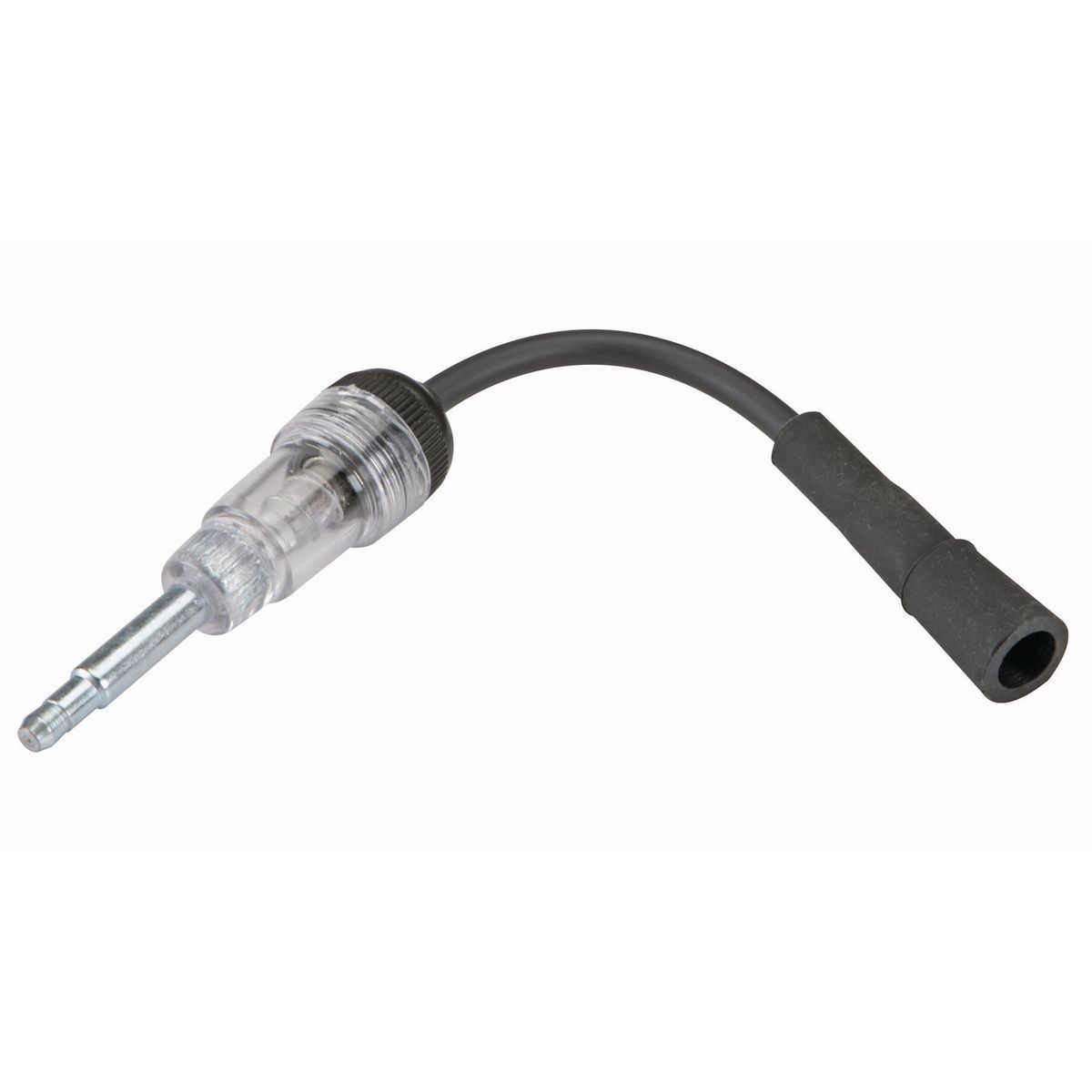

You could also add a spark tester inline to see if you are losing spark as it dies or if it keeps sparking.
These inline testers make that easy and they are cheap at places like harbor freight.
