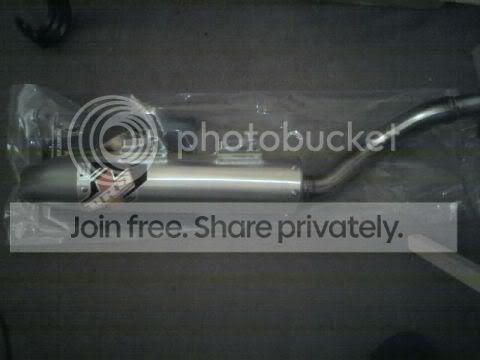

ohhh yeah got my exhaust today!!!!!!! [img]i/expressions/face-icon-small-happy.gif[/img]

The Dr. D exhaust looks nice. I've heard good things about those systems. Be sure to post your first ride report.

That pipe looks pretty sweet. The difference between stock and new pipe w jets is HUGE! I have had my pipe for two days and I can't ride enough. I was kinda disappointed though, the pipe they sent was different than the picture, but I called CT and they said there was no performance difference they just changed the look. The tube leading into the canister is not expanded it is same size as the header pipe. I ordered it from phil's cycle in oklahoma, I guess they had it for so long the design changed. I was so excited i bolted it right on changed the jets and took off. Didn't realize pipe was different until after first ride. can't really send it back now. Oh well I'm sure the difference is so minimal it probable doesn't matter. Another big difference is the sound, new pipe is LOOOOOOOUUUUDDDDDD!! stock is around 83 db new pipe is 101 or so, but tunable. I pretty much have to idle out of the neighborhood now, any gas and pictures start falling off the wall. thanks for all the help guys.
