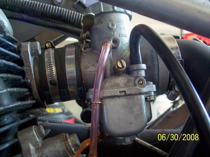

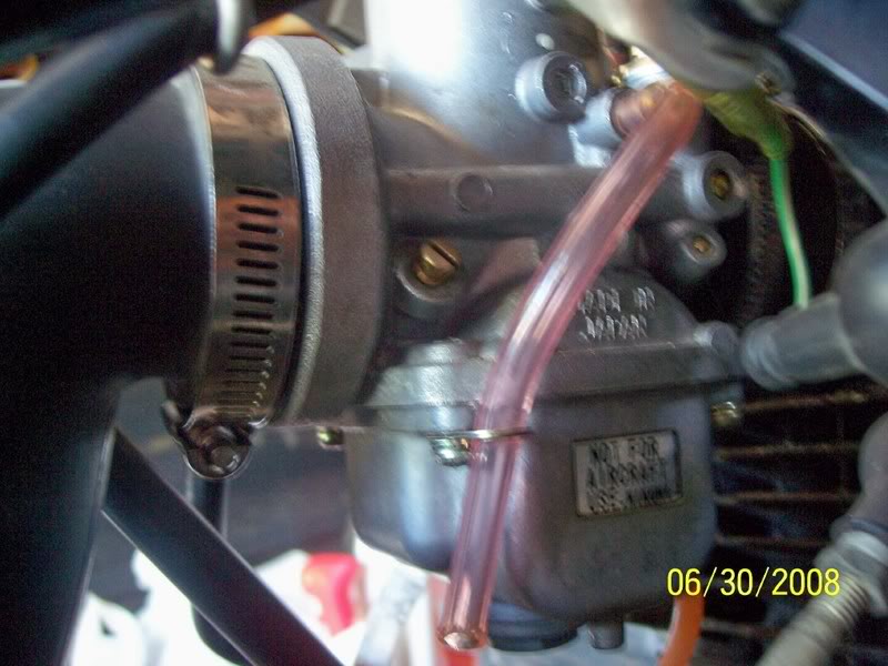

Okay back from vacation so at it again trying to get this machine to run smooth. there is no ID on the carb, and per the service manual pics I don't believe this is the original carb.

took some pics of all views - did take the gas tank off too, since I need to change out my throttle cable. I won, on ebay a stock cable with another thumb throttle, so I am hoping this setup works. It runs great, and as long as I don't hit higher rpms moves fine too, but as soon as I let the rpms go up close to the shift point it runs like crap, and will cut out as well.

nope thats not a factory carb

So - any way to tell what size it is, or am I going to have to take it apart? Also any more suggestions on my running issue? The dealer is closed today - will be heading over there tomorrow for some advice.
