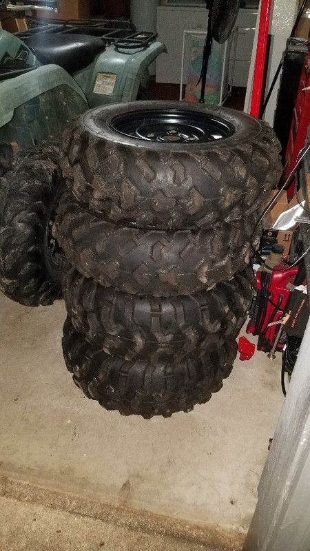

Thanks I'm not a racer I ride mostly in the woods and putting along in 2nd or 3rd is fine. But don't want to give up the burst of power to go up the little short banks.was looking for a couple inches for the creek crossing. This is my first unit, I'm 69 just want to play some. Thanks again,
Lots of tire room but don't want to lose torque

If it's 4x4, whatever size you decide to go with, make sure you match the sizes in the front and rear (height that is). When I first got my 4x4 Timberwolf the previous owner had 24" on the rear and 23" on the front, which is terrible for the drivetrain because of the different tire speeds causing binding. Before I realised that's what the issue was, it was almost undrivable on pavement over 20mph or so because it would sway and wonder all over since the rear was fighting the front... As soon as I put on the matching 25" front and rear, that issue went away.
