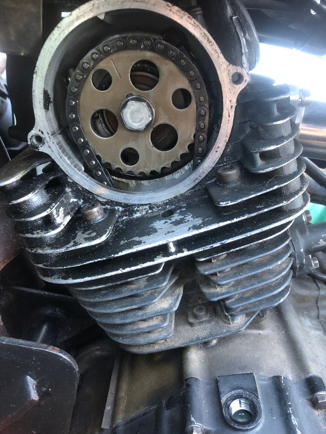

Now it’s not even starting, i posted a new thread and a guy said it could be timing. i put new the carb to engine manifold with some gasket sealer. Been busy. Gonna check if timing jumped today. Also the fuel thing was cuz i barely had anything in it. I changed the spark plug so i’m gonna see if it’s that too

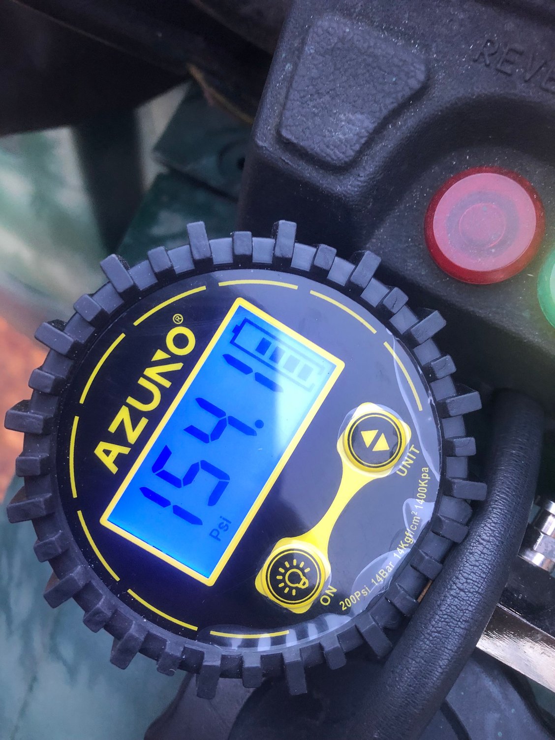

Nope, timing looks good. just checked spark and compression they look good as well. maybe i got a faulty carb? any ideas?
