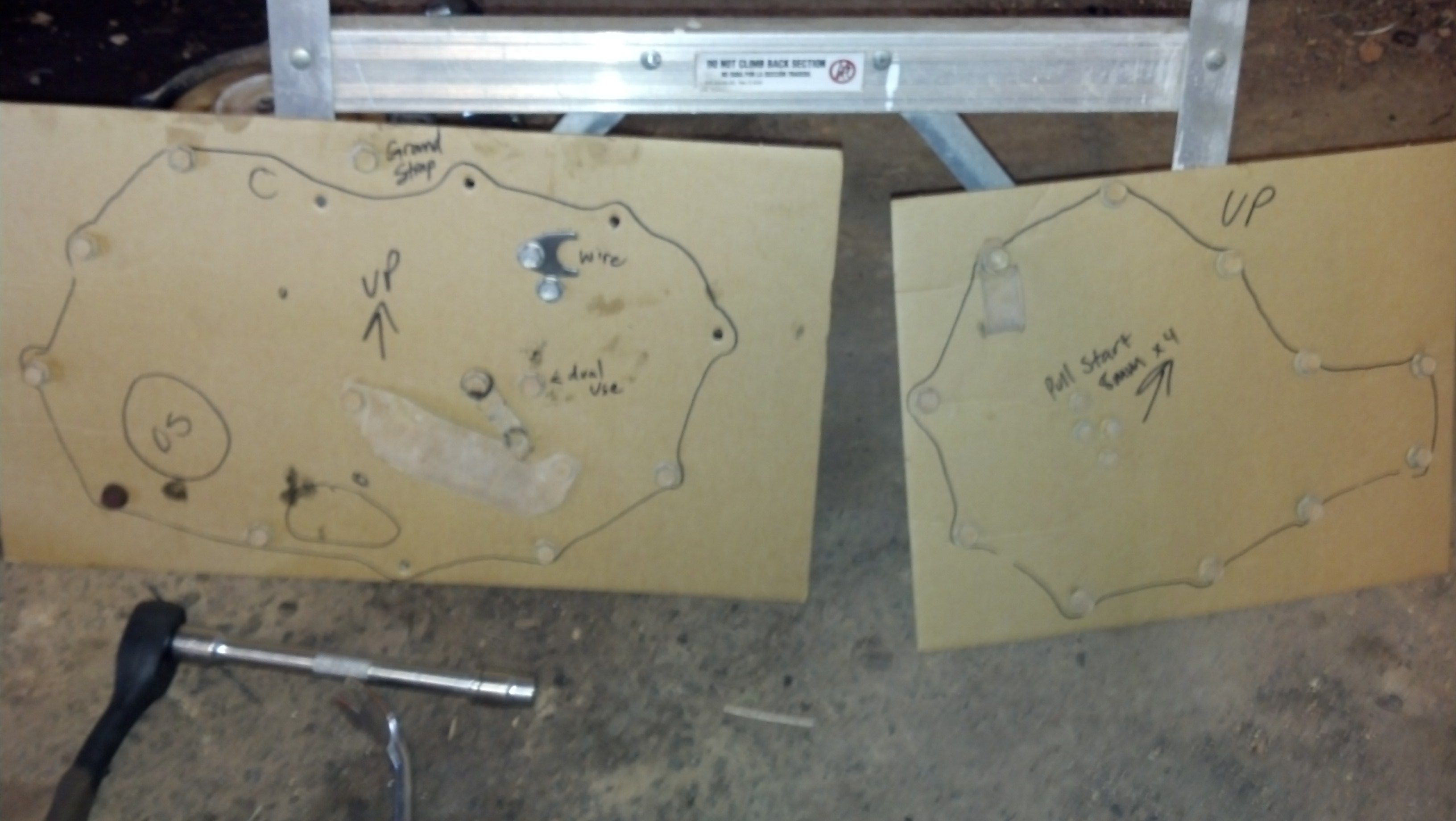

Before we turn any more wrenches, you'll notice your two gaskets have nice pieces of cardboard protecting
them. Lets use those as drawing boards and trace them. Then punch the bolt holes with a screwdriver and
you have a handy place to store your bolts since there are several different sizes that will come out of this cover.

You'll note that on your cardboard some bolt holes are missing...that because some hold both covers and go through
both gaskets. I have lined the gaskets up in this picture so you can see where they overlap:
Here's my artwork:
